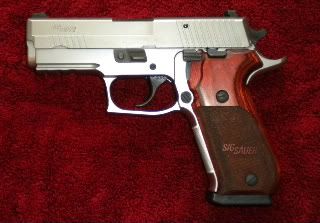

    Here's what I carry. It seems to do pretty well as far as meeting most of your criteria

    RockBottom, ua posted a pic of a beautiful handgun. my favorite carry after i changed out from a colt defender is my Sig p239/40, 1st gen
    bet it is a joy to handle and shoot.
    but for the -0-chamber carry, i did not include the decocker Sig's cause of the extra time to cock the hammer ( as a cocked hammer lets the slide move easier helping to ensure
    that one does not short stroke the slide when one handing it). also the ejection port is square to the top of the slide allowing for the possibility of fabric to get tangled.

    Thanks. I've put several hundred rounds through it with nary a hiccup. It handles Speer Gold Dots really well and shoots straight. Racking one handed is doable, but it's a chore. After what I've read here, if a bad guy ever sees it, he should assume that there's one in the chamber.
