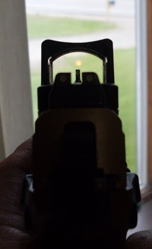

    Cool to see so many folks with mini red dot equipped pistols here. I recently transistioned from carrying a 1911 on duty to a Trijicon RMR02 equipped FNP-45 Tactical. I'm impressed enough with the "red dot on a pistol" concept that after trying the FNP-T I also purchased a one-off RMR equipped FNS-9 from One Source Tactical. While none of this makes me an expert I think I might be able to contribute to the discussion and answer some questions.
    First, IMO, the biggest difference with a MRDS (Mini-Red-Dot-Sight) on a pistol is that your entire sight picture changes. As mentioned early on in the thread you're only dealing with one focal plane (dot and target) with the MRDS vs three (rear sight, front sight, target) with conventional iron sights. What this means for the shooter is that instead of lining up the sights on the target then focusing on the front sight, which leaves your target blurry, with the red dot you focus on your target and superimpose the dot on the target, both the dot and the target are in perfect focus. From either the defense or offensive perspective, this is a huge advantage as you maintain a clear view of your target at all times. Another thing about sight picture and the MRDS is that, for those of us with less than perfect vision, it eliminates the issues that come with corrective lenses. I've been wearing progressive bifocals for a few years now and they make aquiring a proper sight picture with iron sights more difficult because I have to tip my head back to find the "sweet spot" in my glasses to focus on the front sight, taking even more from my view of the target. When using the dot I can look through the upper area of my lenses as I normally view things and both the dot and the target are in focus. Having the red dot on my sidearm also gives me a similar sight picture to what I have with my patrol rifle and I like that consistency - two weapon platforms, one sighting system.
    Of course, it's not all wine and roses. As Damon brought up, it does require training/practice to be able to utilize an MRDS on a pistol to it's full advantage. You are working against your iron sighting habits, all those years of aquiring the sights and focusing on the front sight are tough to undo. I found a tendency to want to look at my sights rather than the dot, it took a while (lots of draws and dry fire practice) to trust and use the dot first. That being said, if your pistol is properly equipped with suppressor sights they do help with aquiring the dot faster if the dot is cowitnessed with the sights. Line up the sights and the dot appears on the target. After a while your presentation changes enough that you start finding the sight first and that speeds things up. Another thing that you will notice immediately is that the dot makes any instability in your stance and hold very obvious because any movement causes the dot to move on the target, you don't get the same effect with iron sights because you're focused on the sight, not the target.
    Of course, if you've never learned any other way then learning to shoot accurately with the dot is much faster than learning with iron sights. My wife has issues with proper sight picture, I don't know exactly what the problem is because she doesn't have the shooting knowledge base to explain it to me in terms I can relate to. I had her shooting the FNS-9 with only the dot (no cowitnessed sights) and told her to just put the dot on the X and squeeze the trigger. Bam!, bullseye at 10yds, had her do it again and the second shot was practically through the same hole as the first and she was able to do that consistently until the gun was empty, 18rds. She was elated, shooting had always been a chore for her and the RMR allowed her to concentrate on the target and trigger pull instead of trying to work out the iron sight equation.
    The size of the sight, weight, holsters, and concealed carry are not the issues a lot of people think. Yes, the sight adds to the height of the gun but doesn't change the concealablity of it because your adding to the top of the slide rather than the butt end so it doesn't stick out anywhere. The weight of these things is neglible and mounting one does not affect the balance or function of a pistol. In fact, my FNP-T, with the RMR mounted and loaded with 16rds of 230gr ammo actually weighs 1.5oz LESS than my old duty pistol, a Springfield 1911, loaded with 9rds of the same ammo. Holsters need only be cut low enough in the front to accomodate the sight, some holster makers like Blade-tech are really going out of their way to accomodate the growing trend of red dot equipped handguns and will make the holsters specifically to work with one. My duty holster is a Blade-tech that is relieved to fit the sight, they are developing one now that will have a molded in sight cover to protect it, they already make these for Glocks and they're sold through OST. Any holster maker should be able to modify their designs to fit an RMR equipped pistol as long as it doesn't interfere with any retention devices.
    Sorry for being so long winded. I've been working with these things for a few months now and these are some of my observations. I've become much more comfortable with the sights and, while I'm still not as fast as with my 1911s overall, my accuracy has improved, especially beyond 15yds. Also, my shooting has become more deliberate, the dot makes me more aware of where my bullet is going so I'm looking for a more settled sight picture than I did with iron sights. I hope this all helps, I've added pics of my guns below.
    My FNP-45 Tactical and FNS-9, both w/Trijicon RMR02 optics-
    This is what you see when focused on your target, everything is clear and the dot is sharp-
    This what you see when focused on the front sight, everything but the sight is blurry-
