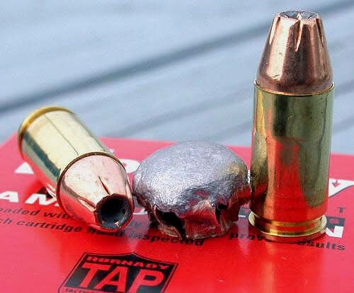

    While not Fiocchi brand, here is an expanded Hornady factory-loaded XTP recovered from "wet pack" in an informal "test" I did some years ago. It was fired from a Browning Hi Power. Average velocity was 1143 ft/sec. I expect that Fiocchi loads to at least this velocity...and probably more. (I have seen its velocity listed at 1290 ft/sec but have not personally chronographed any to see if this is true or not. That said, I think it is a safe bet that its velocity will be sufficient at the least.)
    If the Fiocchi velocity is in the range mentioned above, it will likely perform like the 124-gr. XTP's in the picture above. This were fired from a Browning Hi Power and averaged about 1244 ft/sec. The one on the left was used to kill a javelina while the one on the right was fired into water.
    I would not be "concerned" if using Fiocchi XTP ammunition for self-protection.
