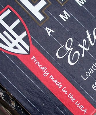

    Hello. I recently bought some of the Fiocchi 9mm Extrema line of ammunition in 124 and 147-grain loads. I've not used these particular factory 9mm loads before and folks on-line seem to be interested in them.

    Hello. Fiocchi USA manufactures this ammunition.
    Best.

    IME, you will never get the velocity from saami loaded rounds you will get from cip loaded ammo. Ammo loaded here in America is subject to saami pressures, not cip. IIRC, these rounds (115 and 124 gr.)are loaded to cip pressures in their home country, which is Italy. I know we import some of this for I have seen it on some websites.
    Why Fiocchi tranfers those published velocities to their ammo made in the USA I don't know, but apparently that is what they did.

    Billinmiss, not entirely correct. If the ammunition manufacturer is a member of SAAMI, they must follow their standards. If the ammunition manufacturer is NOT a member of SAAMI, they can do what they want.
    Fiocchi USA is a member of SAAMI. What you don't know is how they test their ammunition to obtain the ballistics information published. That will indicate a lot.
