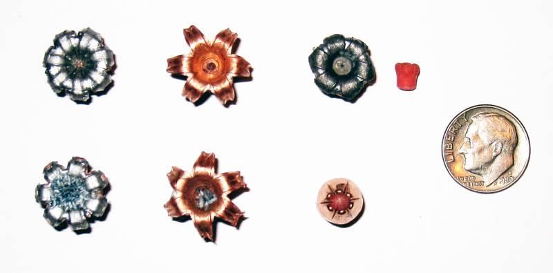

    Good question. To be fair, I wasn't thinking of wound-channel and bleed-out, but rather the odds of hitting something vital. Here's a pic I've posted before showing the expansion pattern of Corbon DPX in .38 spl:
    Now see, that's the kind of stuff I look at and think how could anyone look at these expanded bullets and not think the bigger ones are gonna do more damage?
    That raises the question: If a 9mm bullet expands by 27% that would make it the same size as an unexpanded .45 round. Would there be any difference between the two as far as the wound channel goes? The twist rate of handgun barrels is in a range from 1 in 10 to 1 in 14 inches. That means the bullet makes one (1) revolution (360°) in the specified length (10 to 14 inches). From this and the velocity of the bullet we can estimate it's rpm. Let's take a 1:12 twist and 1150 fps. the 1:12 is not only the middle of the range, 12" = 1 ft makes the rpm Assuming the bullet leaves the barrel with the implied twist imparted to it, we can calculate rpm:
    (1 rev/ft) X (1150 ft/sec) X (60 sec/min) = 69,000 rpm!!!!
    You'd thing those petals on those bullets spinning at 69,000 rpm would cut through flesh like a buzz saw! But apparently, it some how doesn't work that way.
    Further it is extremely difficult to explain why an expanding bullet of a smaller caliber is perceived to be more effective than an unexpanded larger caliber bullet that's the same diameter of the expanded buller.
    But regardless, it would be reasonable that the expansion of a larger caliber would be proportional the the expansion of a smaller caliber, so even with expansion, the larger wound cavity concept would still be proportional to the difference in bullet size.
    You can see why I like the Corbon. That ragged petal shape is going to cut things as it moves through the target. If Corbon makes a .22 round, it will be of smaller diameter than the .45. Given two shots to the exact same spot, the larger caliber will have a larger diameter when the hollowpoint opens fully. The chances of the larger round hitting something vital in the CNS and effecting a stop are potentially greater.
    But that's all assumption or unproven theory at best. We need to remember that those petals take time, distance, and energy to form. The fully expanded form may not exist until the bullet has travelled for some distance into the body and most of the spinning may have stopped by then as well.
    But whatever happens, and I don't know, but we must assume that those persons that have studied and treated bullet wounds for many, many years have the same knowledge and logic that we do, but we never hear them mention any of this. All they talk about is they can't tell from the wound what made the wound. I'm not sure that they can even tell if the wound was made from a smaller caliber bullet that expanded or a large caliber bullet that didn't.
