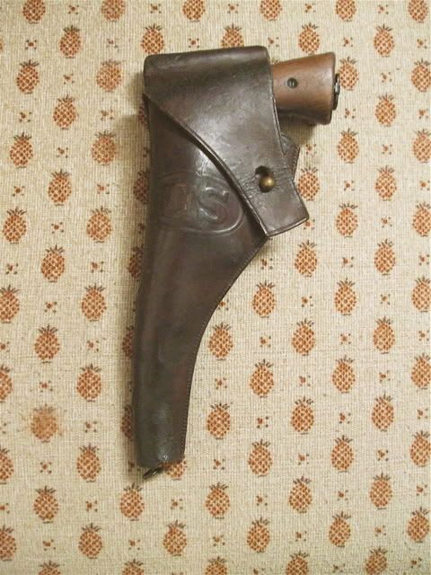

    Some say the old .38 Long Colt revolvers should be retired and not fired at all but I don’t intend to put mine out to pasture completely. I’m a history buff and enjoy hands-on experience with historical firearms. I use carefully prepared ammunition put up in proper .38 Long Colt cases. Parts breakage is a real possibility and the only Colt revolver that ever failed me is the Model 1901, which once broke a trigger return spring. Colonel Snodgrass of Fort Worth, Texas made a perfect replacement spring for me. The lock work is delicate and one would be wise to cock the hammer smoothly when using the revolver in single action mode rather than snapping it back to full cock. Stay away from rapid-fire double action shooting as well, instead pulling the trigger through smoothly so as to avoid battering the locking bolt and cylinder notches. I’ve never used the Colt Model 1877 “Lightning” revolver but they have a reputation for being even more fragile so take care with them as well.
    Range time with one of the old Colt Army .38’s is good fun. The revolver with its six-inch barrel feels most elegant when sighted using the one-handed hold characteristic of the time of its issue. My revolver hits to point of aim at 12-15 yards with the 148 grain HBWC handloads or factory loads if I make careful use of the miniscule sights. Recoil is mild. The single action trigger of my Mode 1901 is quite heavy with a bit of creep, which makes it a chore to shoot really tight groups. The double action function is not a good experience. Heavy and uneven best describes it and my revolver is tight and properly timed. Did I say it has a bad double action? One will probably fire a few rounds double action for effect and the novel experience but a few will satisfy curiosity.
