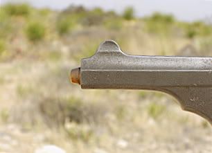

    I've shot a lot and over the years have had the odd squib load. Mostly, they have been factory loads but this one from a few resulted from an effort to handload copper plated bullets too light. I was intending to load a mild plinking load that wouldn't be stressful to my old 1899 vintage Webley Mark IV .455. A sickly report found the bullet sticking out the end of the barrel. "Almost, but not quite nearly" made it. I had to increase the powder charge a bit.
    It was great for a laugh and a photo but squibs are decidedly not funny if they damage barrels like HotGun's.
