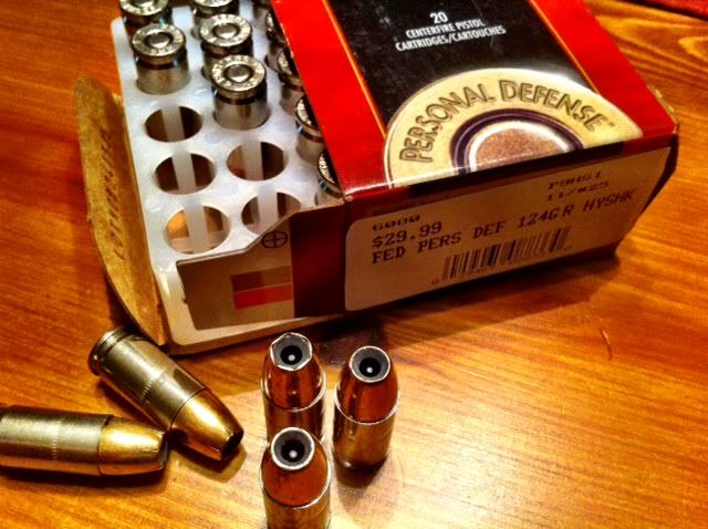

    Experimenting now with Federal Premium 9mm 124gr Hydra-Shok:
