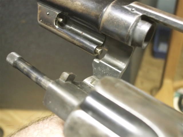

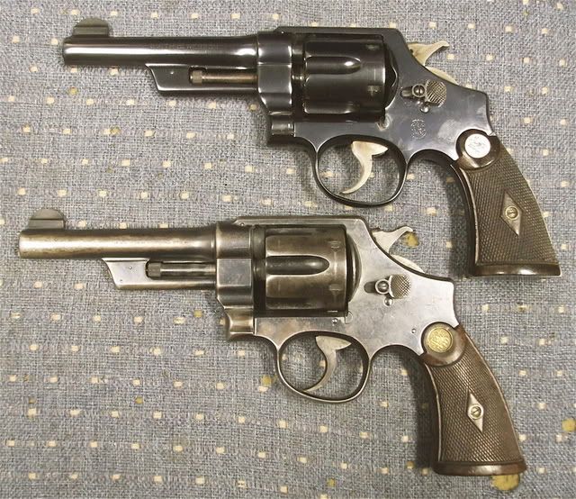

    I need to make a new photo of the Smith & Wesson Model of 1926, shown here (top) on a visit with a friend's Smith & Wesson New Century Hand Ejector .44 Special (bottom). Otherwise known as the famous "Triple Lock," this unique variation which was manufactured for only a few years from 1908 to 1915 and represents the apex in the development of all Smith & Wesson swing-out cylinder models ever created in my opinion. The third locking point was said to be very labor intensive to manufacture and fit. The craftsmanship that went into any pre-war Colt or Smith & Wesson guns is astounding, even on worn examples. The Triple Lock shown was manufactured around 1909 if I recall correctly.

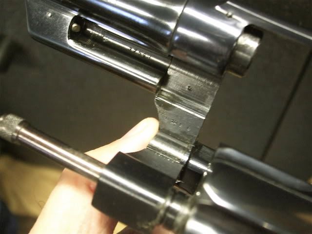

    For those interested, here is the special third locking point, unique to the Triple Lock revolver.
    The Model of 1926 or Third Model reintroduced the ejector rod shroud but is without the third lock. The 2nd Model remained in regular production and the Third Model, introduced in 1926, was available as special order simultaneously. Both were temporarily discontinued when Smith & Wesson participated in the War effort after 1940.

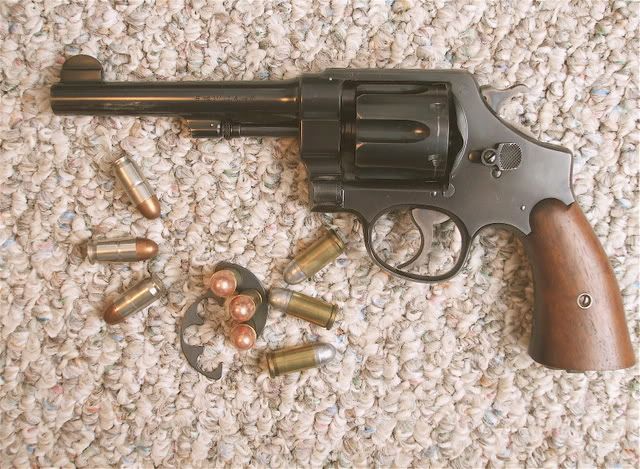

    For an example of the appearance of the Second Model this Model of 1917 .45 ACP will serve. The Second Model began replacing the Triple Lock in 1915, though a few Triple Locks were sent out of the factory as late as 1918. This one, manufactured to Second Model specifications, was made in early 1918. Notice the deletion of the ejector rod shroud and of course the third locking point. All three variations were built on the N-frame design which is still manufactured today.
    Most probably don't much care about such dusty old gun lore but it can be fascinating to trace the development of gun designs.
