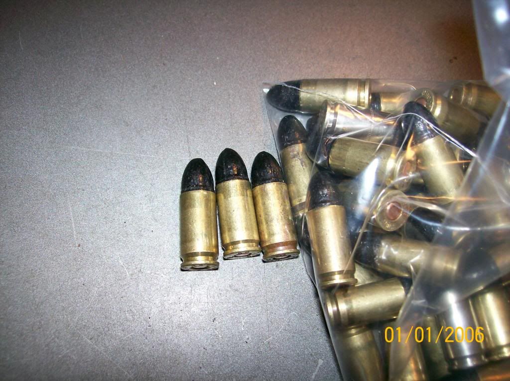

    After watching a video and doing a little research about coating lead bullets with an epoxy coating that not only prevents any barrel leading,but allows the bullets to be loaded close to jacketed velocities,I decided to try some.Last week I received some HBN (Hexagonal Boron Nitride) powder that is a really fine lubricant like graphite,Today a 1/2 pint of high gloss black epoxy car paint with the hardener and reducer will be delivered on the brown truck,and I will do some experimenting,I already had a toaster oven in my garage for another project so my only expense will be the paint and HBN.If It works then the indoor range I'm a member of that doesn't allow non jacketed lead bullets I will be able to shoot these at and save a ton of money since the cost per round shouldnt increase by more than maybe .01 cent which will still be around $6-$7.00 100 9/40/45

    I finally got the bullets coated,125 grain 9mm roundnose it was pretty easy once I got everything set up and used a tablespoon to measure out paint 2 TBSP epoxy paint/1TBSP hardener/1/2TBSP thinner and 1/2 of a .5cc lee powder measure of the HBN lube.The finished cartridges not only shot accurately but there was no samoke at all.In the following pictures you can see where I hit 2 of the coated bullets with a hammer one on the nose and one sideways,there was no cracking or flaking of the epoxy coating
