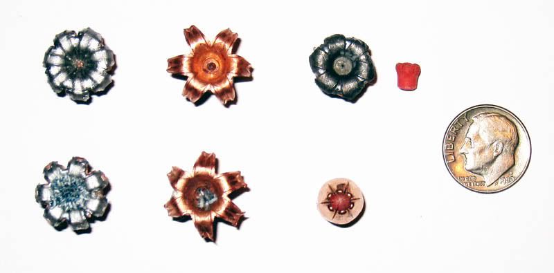

    Look at these 9mm bullets after expansion. Look at the one that you'd most want to have. It's the Corbon DPX 9mm. The others are your Speer, your Hornady - not the worst, but nothing can match Corbon DPX.
    Can you provice what round is what? like weight, charge, etc.
    The 2nd from left with the separate parts had better expansion, but it looks like the area of expansion is smaller than the one on the left. If the energy for both is identical, which would have the best stopping power?

    Second from left, upper, is the DPX 9mm 115-grain +P. It reliably opens with sharp, jagged edges, even through 4 layers of denim (as tested).
    As anybody will tell you, there's no magic bullet, no perfect round. Placement trumps all other considerations. Hitting your target beats anything. The best hollowpoint and worst full metal jacket all do about the same job. I'd never claim that one round is better than another.
    Still, I spring the extra few bucks for the Corbon. I want those sharp, jagged petals doing that special job that they do.
