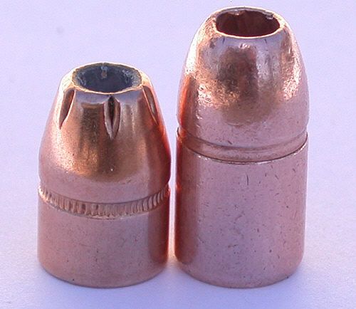

    Hello. Hornady XTP's are conventional lead & jacket hollow points originally designed to expand about 1.5 x original diameter. When they first came out the XTP was advertised as meeting or exceeding the FBI's penetration protocols for service handgun ammunition. DPX is a solid copper alloy hollow point bullet. It, too, offers very good penetration in most loads and expansion is pretty consistent even when intermediate barriers are involved before the bullet penetrates the "soft target".
    These are 125-gr. 38-caliber bullets. The one on the left is a Hornady XTP. On the right is the DPX bullet, which is longer for the same weight due to its copper-alloy construction. The copper, being less dense/heavy than lead makes a longer bullet for the same weight.

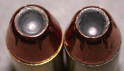

    These are two 230-gr. 45-caliber XTP's I've handloaded. Note the difference in hollow point depth. The bullet on the left is several years old. On the right is one from a much more recent production lot and appears to have deeper hollow cavity. This seems to be in line with reports that Hornady has "tweaked" some of their XTP's to provide a little more expansion than in year's past. I have not seen any of the "new" Hornady XTP's in tissue.
