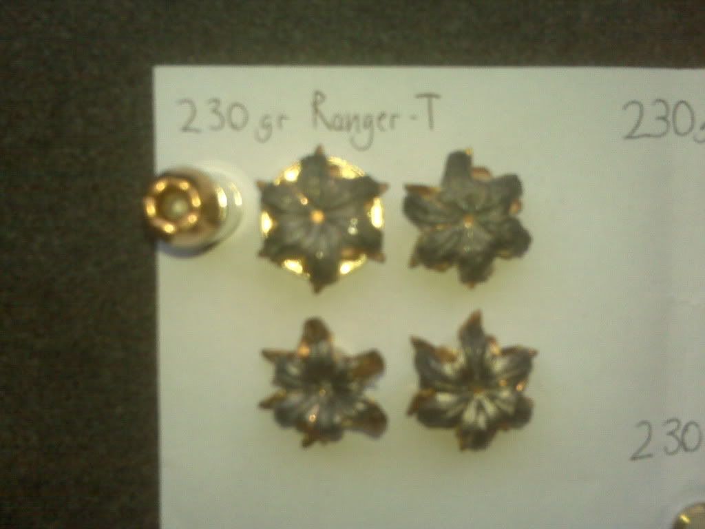

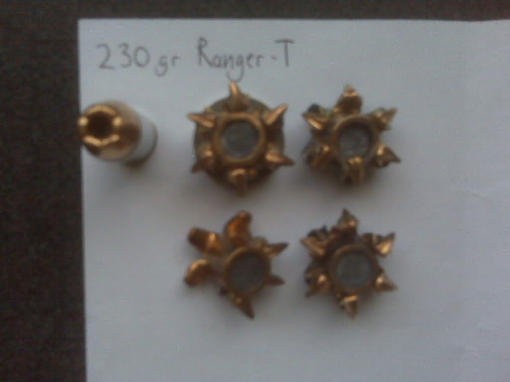

    Winchester Ranger-T 230gr 45 acp
    PB
    max= .99 min= .98 core= .82
    max= .96 min= .93 core= .82
    WJN
    max= .96 min= .82 core= .72
    WJ
    max= 1.00 min= .98 core= ..87
    Very impressive, the talons are very sharp and would leave one nasty permanent cavity. I think the more rounded bullets will just push a lot of tissue out of the way, but with these the talons will shred as it pushes past. The expansion is not as consistent as the HST, the talons vary widely with some pointing straight out, some pointing up etc. penetration seems to be a little less than the 230 gr HST, usually stopped in the 3 jug.

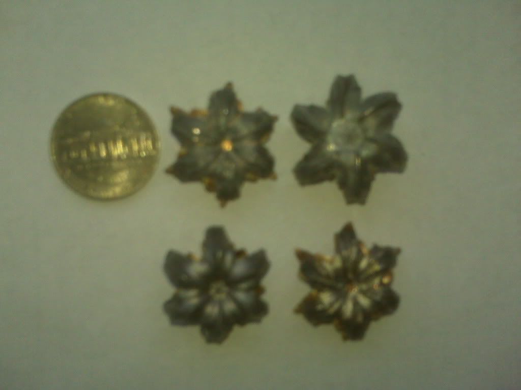

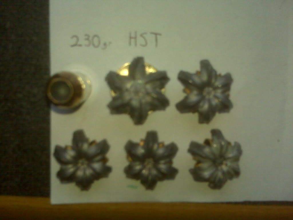

    Federal HST 230gr 45 acp
    PB
    max= 1.01 min= 1.0
    WJN
    max= .96 min= .95
    max= .88 min= .87
    max= .89 min= .88
    WJ
    max= .89 min= .88
    I don't think you could go wrong with the HST or Ranger-T but I like the HST slightly better due to the consistent expansion and better penetration from what I have seen. They also left some pretty nasty looking holes in the phone books and water jugs. The edges on the petals really do leave cuts in the water jugs. I also think that the thicker pedals on the HST would due better when hitting bone and harder structures. The HST seems to due a better job of keeping its jacket in tests I have seen on ATK's website. The 4 shots into water jugs almost look the exact same. Consistent expansion around .90 inches.

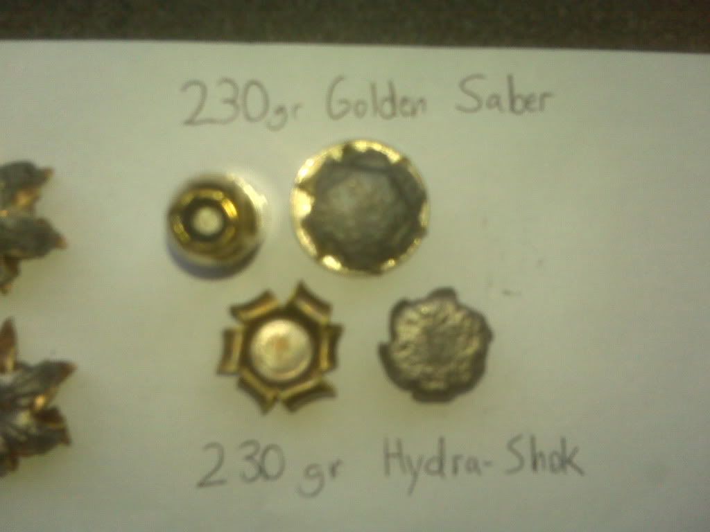

    Remington Golden Saber 230gr 45 acp
    PB
    max= .79 min= .72 core= .66
    WJ
    max= .78 min= .75 core= ..66 *Core Jacket Separation
    A note on the core jacket separation, the core and jacket stayed intact into the 4th water jug, then it looks like it separated at the end of its travel. These did out penetrated almost every round. I think these are good rounds, but still outclassed by the Ranger-T and HST. The jacket petals will do some slicing of tissue but not nearly as much as the HST or Ranger, yet far superior to the older Hydra-Shok and XTP.

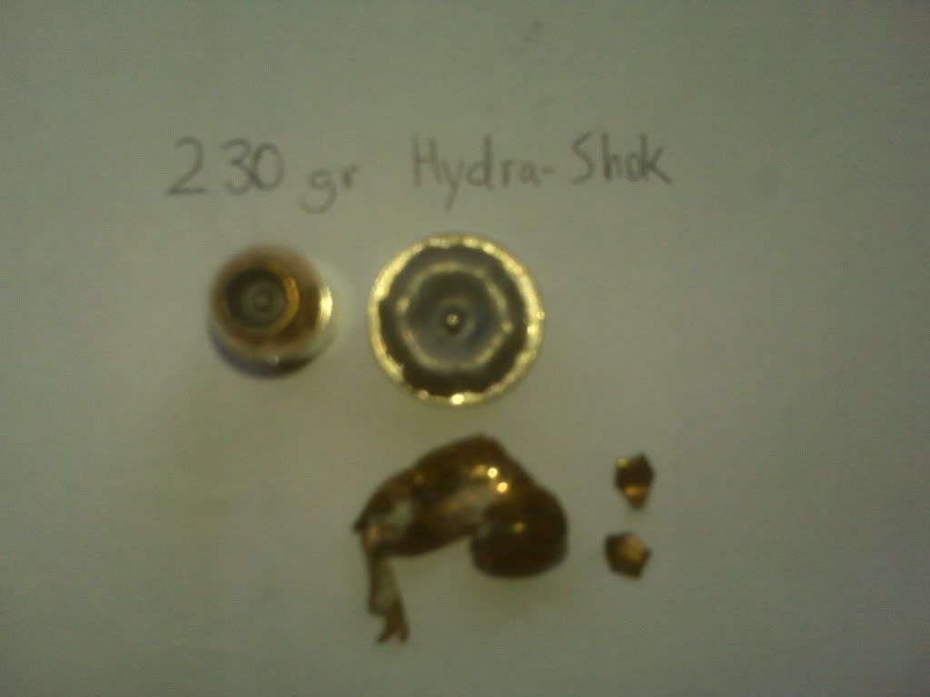

    Federal Hydra-Shok 230gr 45 ACP
    WJN
    max= .68 min= .67
    Failed to Retrieve
    The hydra-shok is pretty old technology and I think it is still an OK round, but it is really outclassed by the newer offerings. The 2nd shot shed its jacket as you can see and the core just kept going into the side of the hill. The jacket was found in the back of the first jug filled with newspaper. The first shot penetrated good and had ok expansion. I would not feel comfortable carrying these due to the issue's they have with the post plugging with heavy clothing and turning into a FMJ.

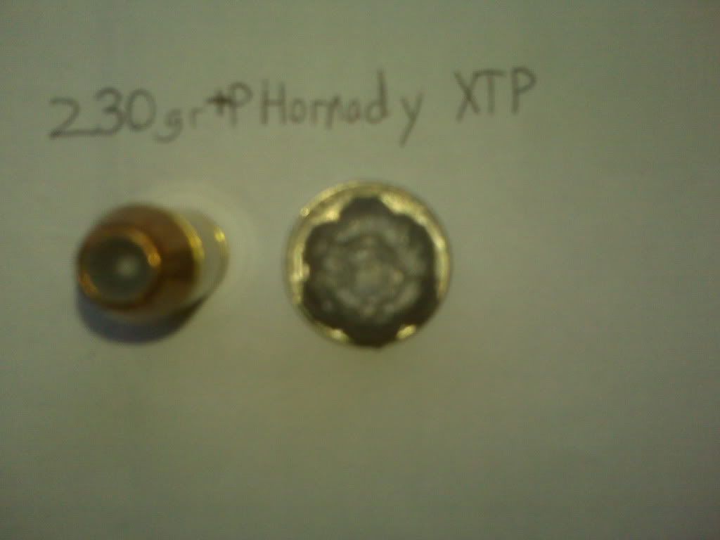

    Hornady XTP 230gr +P 45 acp
    WJN
    max= .68 min= .67
    They seem to get the job done, they fully expanded and penetrated very well. Like I have said before there are better options out there but I would prefer these over the hydra-shoks.

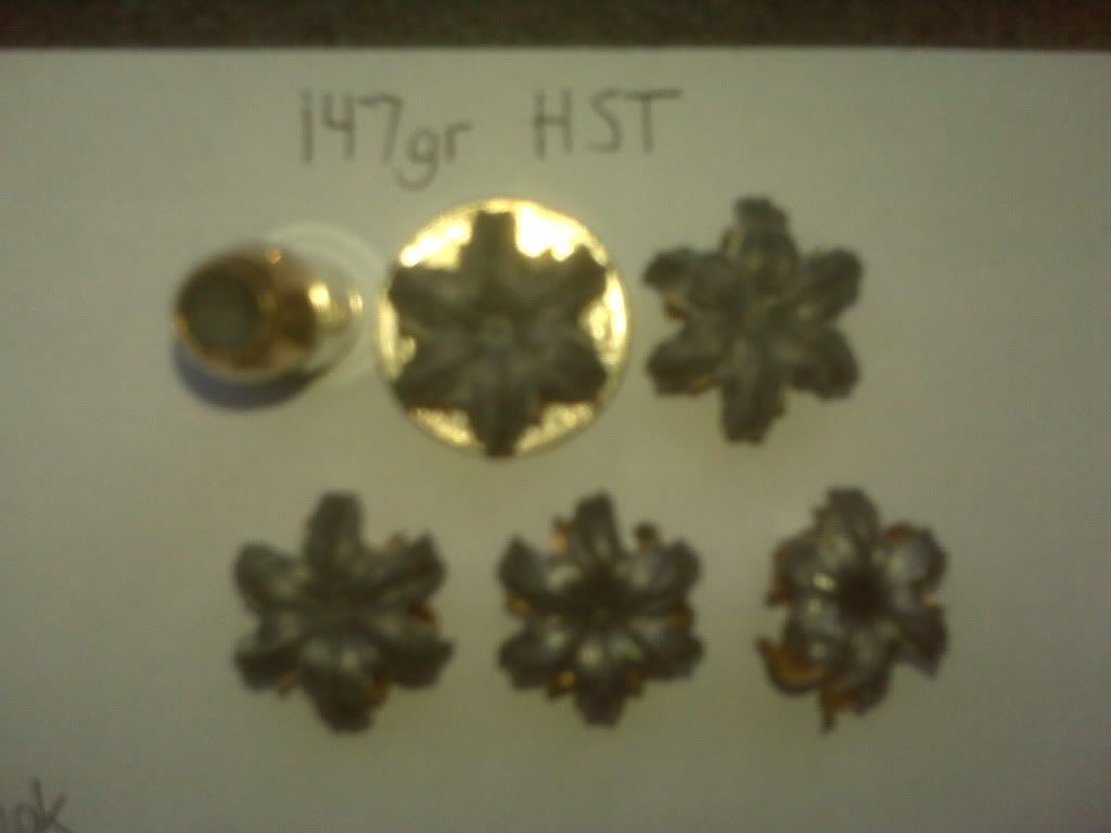

    Federal HST 147 gr 9mm
    PB
    max= .78 min= .74
    max= .78 min= .76
    max= .73 min= .71
    WJN
    max= .72 min= .71
    WJN+Pork Ribs
    max= .75 min= .58
    These are my favorite load in 9mm so far. They expand consistently and penetrate well. Same comments apply that I made with the 230 gr. It kinda feels like packing a 45 in 9mm when you look at the expansion. I was impressed with the performance when hitting bone. It clipped half of the bone and kept going straight while expanding. I would like to due more testing using pork ribs, but that is far more expansive than using used water jugs.

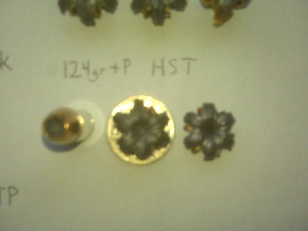

    Federal HST 124gr +P 9mm
    PB
    max= .73 min= .69 *2 Petals broke in half
    WJN
    max= .68 min= .67
    These are pretty impressive and my favorite in 124gr, they do pack more punch than the 147gr but I am not a believer in hydro-whatever shock so the temporal cavity isn't that important to me. The petals broke off towards the end of the bullets travel in the phone book.

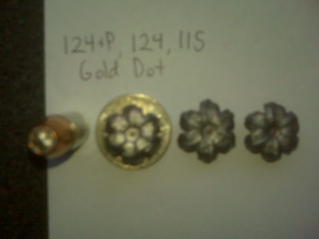

    Speer Gold Dot 124gr +P 9mm
    Speer Gold Dot 124gr 9mm
    Speer Gold Dot 115gr 9mm
    124gr +P
    WJ
    max= .63 min= .62
    124gr
    WJN
    max= .67 min= .67
    115gr
    max= .63 min= .62
    I like the Gold Dots and they all had good penetration. Expansion was average, but pretty uniform. I would like to do more testing with the 124gr+P as i think they are a great round. They definitely had the biggest splash when shot into the water jugs.

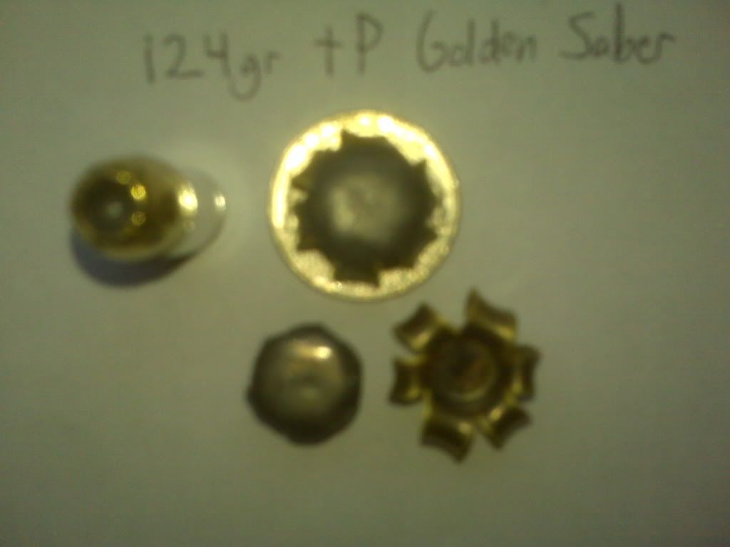

    Remington Golden Saber 124gr +P 9mm
    PB
    max= .68 min= .63 core= .50
    WJ
    max= .71 min= .65 core= .50 * Core Jacket Separation
    They performed about the same as the 230gr 45 acp, good penetration and good expansion. The Core Jacket Separation was also at the end of expansion in the last jug. I think it would only be an issue when going through heavy barriers like auto glass.

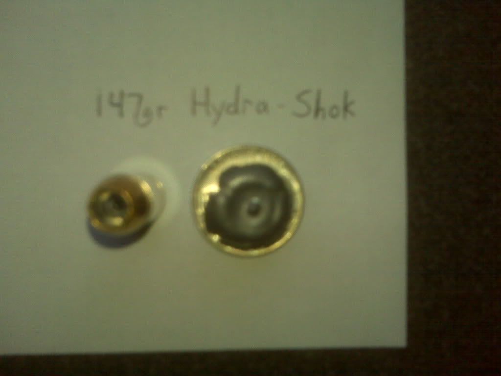

    Federal Hydra-Shok 147gr 9mm
    WJN
    max= .61 min= .60
    These did better than I thought they would but just about everything I said about the 230gr applies.
    Lastly I have some comparison shots of the HST vs Ranger-T. Both are pretty nasty. I would like to due more testing with the 9mm Ranger-T including the 127 +p+ and 147gr but my order is back ordered. Sorry for the crappy pictures, my camera sucks.
