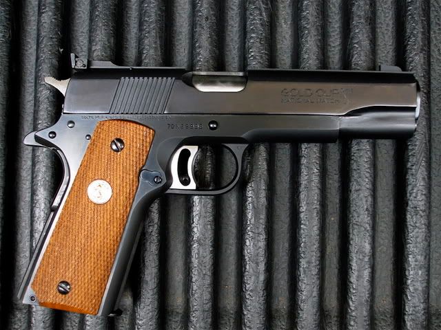

    7,211
    Full length guide rods are so much baggage in my view. Some years ago I did try one in my Colt Gold Cup for about a year. The pistol was already nicely accurate. The full length guide rod didn't impact accuracy at all. It also didn't impact function at all. In fact, it just did nothing.
    When disassembling the pistol, it became an aggravation I decided I could do without. I was glad to give it the heave-ho.

    Off Of The X
    31,978
    bmcgilvray ~ Nice Cup.
