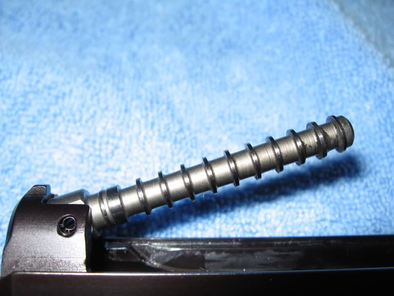

    The exception with the P7 is that it has the Gas piston and tube to inspect. The action should be smooth. Watch, listen and feel for grinding, catching or difficult racking of the slide. Disassembled; the piston may be dirty but the ring's edges should be shiny and smooth. A dirty piston can be cleaned but a pitted or ruined piston has to be replaced.

    The gas sytem is the same in P7 or the M8. If there's an improvemnet, it's news to me. The M8 has a plastic heat shield attached to the trigger guard. That's why the trigger guard is bigger than the P7's. I'm not sure how well the heat shield works... some say fine, others say it doesn't help. Either way, the gun gets hot after 75 rounds or so.
    Here's a great pic of what the piston should look like. This one is pretty new.
    pic borrowed from photobucket
