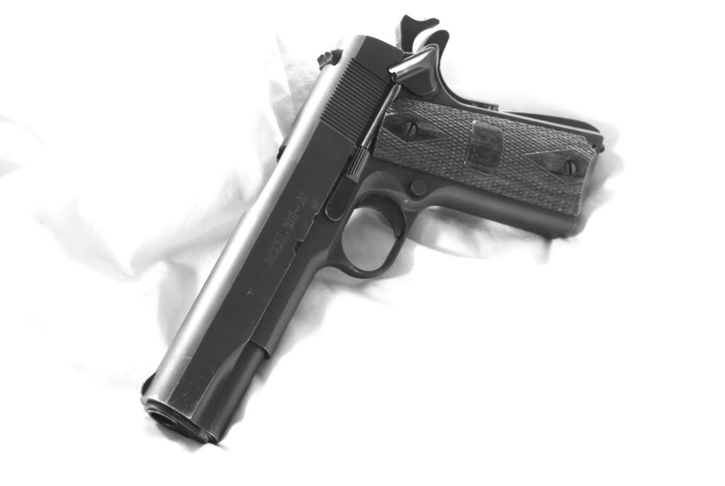

    And so, with a little help from Dremel, we went from this:
    To this:
    The base is a Springfield Armory 1911 A-1 GI. Included in the modifications are an EFK Fire Dragon Bushing Compensator, Pearce Grips Finger Grooves, VZ Thin Gator Grips, Ed Brown Chainlink Mainspring Housing, and Wilson Combat Value Line Commander's Hammer and Drop-in Beavertail Grip Safety.

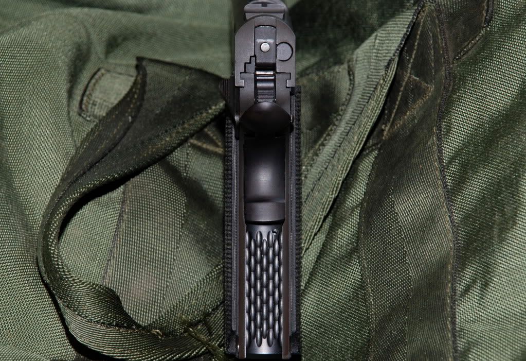

    Viewed from the rear:

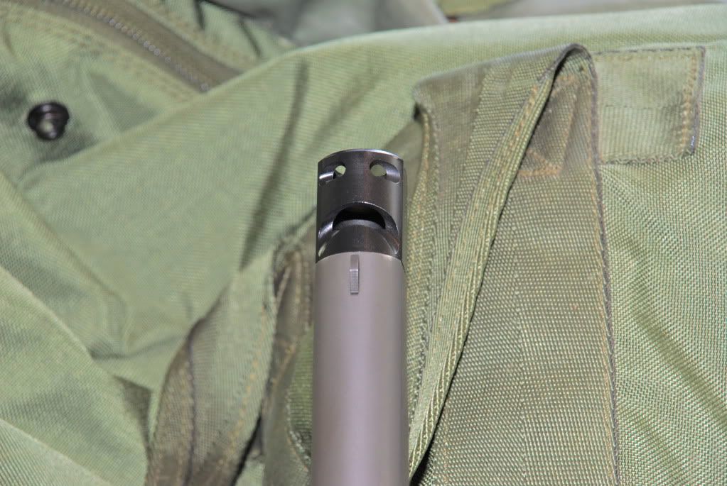

    The compensator's "Face":
    I know the debate in regards to the compensator, but seeing as how the outcome appears to be academic at best or a trade-off at worst, allow me the pleasure of enjoying it's presence. Besides, I think it looks really cool, it fits in my SERPA holster with no issues, and if there is any benefit from having it, then all the better.
    And yes, I know about the night vision thing, but several people have helped to dispel this as outdated information due to modern ammo design and powder formulation. Besides, due to my hands' constant state of Richter Scale Activity, I point shoot most times, so...
    Anyhoo, the pieces mostly went in with very little fitting. The grip safety and hammer were much easier than I had been dreading. The grip safety was stiff at first which gave me some concern, but after a little handling with the ammo in another State, it began to loosen right up. The Mainspring housing was very tight going in, but amazingly, it was much easier to maneuver once it had been inserted all the way. The compensator gave me the most trouble. I had to grind about a gnat's whisker off of the slide slot tab to make room for the recoil spring tube to sit beside it. As always, patience and "small steps" were necessary. Not easy to do when your hands shake like mine...
    Incidentally, I've also polished the feed ramp to an almost mirror polish. I say almost due to the fact that I couldn't remove a couple of the machining lines, and I didn't want to go any deeper than I had to. Manual tests with Hornady TAP have as yet proven to operate without any issues.
    The trigger has actually been improved with a very nice clean break and an awesome reset. I was surprised at this outcome from "Drop-in" parts, but there you have it. I don't think I'll be doing anything else to the trigger for quite some time now.
    I've been considering adding XS "Dot-the-I" night sights because the 1911 is a naturally very accurate design, and although I point shoot as stated above, I like having good options for all occasions. I may also add an extended manual safety for a little better resting place for my thumb's high grip.
    So, I've function checked it to satisfaction and plan to take it to the range maybe tomorrow for an inspection from the RM and some test firing. I have 100 rounds of .45acp that need discharging, and I think this will help that problem out!
    So, that's it. Let me know what you think!
