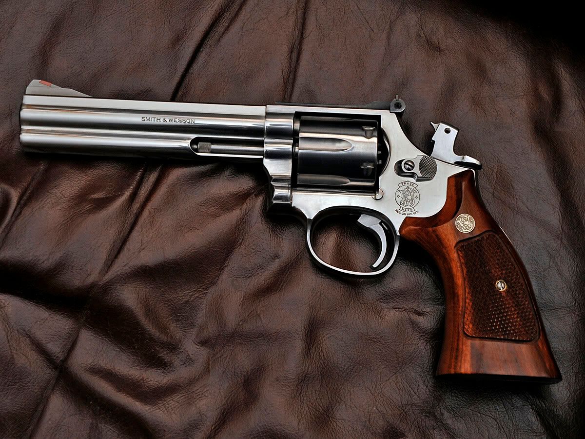

    I wonder if there could possibly be something unique about this old style S&W walnut target grip, that is causing me to shoot left? My S&W 66 has a synthetic grip that feels a lot different.
    Here is a photo of the gun, showing the grip that it has:
