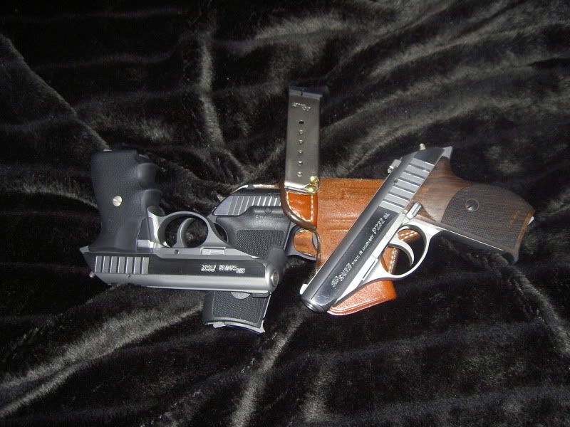

    Me too. I love these guns! A good reason for a gratuitous photo of Sigs.
