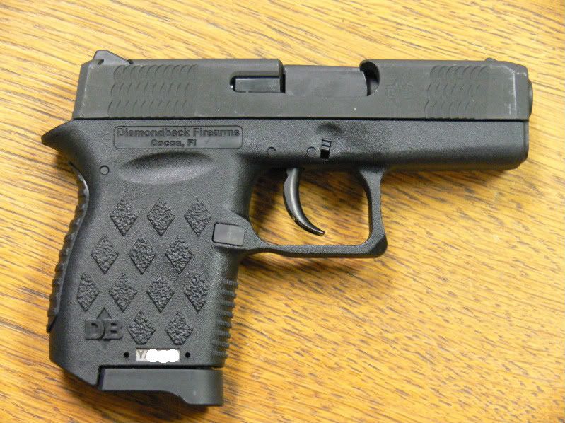

    Here's part of a writeup I just did on the DB-9 for a private forum:
    I just bought this nifty little pistol and shot a couple of mags full out of it. I think I'm going to enjoy carrying it, although shooting it is not all that much fun. As you can see, it is almost identical in size to a Kahr PM-9, but it is noticeably lighter and a lot thinner. The manual says that using +P ammo will void the warranty, but only the shooter will know for sure. Besides, as snappy as the recoil is, you'll not want to shoot +P in it very much. Interestingly, it came with a $25-off coupon for Double Tap ammunition. Guess who makes only +P ammo for 9x19? Yes, I already ordered a box of Mike's +P 124gr. BJHP, which is loaded with Remington Golden Saber bullets, and is his only 124gr. offering. I will NOT be shooting RA9TA in it.
    I looked at two of them, and picked the one with the best trigger, though there was not a lot of difference. The trigger pull is long, smooth, and feels like it is about 6-6.5 lbs. The spec sheet says it has a 5 lb. trigger, but I'm pretty sure this one is more than that. It may settle in at 5. I'll weigh it and post back later. It is DAO with no second-strike, just like a Kahr, which does have a better trigger.
    Mine shoots about 2.5" below the sights at 8 yards, so I'll need to correct that when replacement sights become available. I shot the other one that was in the case, and it shot to the same POI. I have a friend who has one, and his shoots low, too. Seems to be a breed characteristic.
    It is a little more concealable than are my Kel-Tec PF-9s, and the trigger is infinitely better than on the Kel-Tecs. I think it is a lot of gun for the money, assuming it holds up over time and rounds fired. The dealer tells me that another acquaintance of mine has one, through which he's shot hundreds of rounds, including a bunch of +P, and his is doing fine.
    My offhand group at 8 yards was small, and was centered for windage. I'll bench it later, but for the gun's intended use, it is clearly accurate enough.
    Atop a PM-9:
    DB-9 and PM-9, muzzle-on:
    And from the rear:
    One thing you may have noticed is the absence of a slide stop. I have mixed emotions about that omission. The gun also only comes with one magazine, and I don't like that. For me, that makes this a "third gun" at least until additional mags are procured.
    The following figures were obtained with my CED M2, ambient temp about 76 degrees F., front screen about 9 feet from the muzzle. Figures are for three shots with each load, and are rounded to the nearest whole foot per second. I only saved averages and ES, since the sample size for each was small.
    Cartridge Average ES
    Blazer 115gr. 1085 fps. 16 fps.
    Nyclad 124 gr. 1011 15
    C-B Pow'rBall 100gr. 1430 :o 27
    WW Silvertip 115gr. 1033 27
    Golden Saber 147gr. 939 18
    Hydra-Shok 147gr. 915 8
    Gold Dot 124gr.+P 1128 22
    C-B 115gr.+P Sierra Would not chamber*
    * This gun needs a chamber reamer lightly run into the barrel. The leade is too short, and the Cor-Bon Sierra JHP engaged the rifling before the slide closed. I had to rest the front of the slide against a nylon block on the edge of my bench and shove on the grip with both hands to extract it. About one in three of the Gold Dots engaged the rifling sufficiently to make them hard to hand-extract, but they fed fine. I was surprised that neither of the 147gr. loads had an ogive with full-caliber diameter far enough forward to do this.
    After checking velocities, I decided to test expansion in water for a few loads. I'd decided that one of the 147s would likely be best for carry, at least until I can ream the chamber and get a higher rear sight, if one of them would expand. When I get the chamber reamed and replace the sight, I'll put +P Gold Dots in it, I expect.
    I tried the Golden Saber first, and got exactly what I'd expected, i.e., it zipped through two half gallon milk jugs, one 1-gallon milk jug, two 1-gallon windshield washer fluid jugs, and kept on truckin' across the cotton field. All holes were 9mm size, reflecting zero expansion.
    I shot a Gold Dot 124gr. +P next, and it was no surprise, either: It blew hell out of two half gallon jugs, went through a gallon washer fluid jug, and stopped in the next washer fluid jug, perfectly expanded to about .58". (Photo below.)
    The Hydra-Shok was next, and it surprised me. It made it as far as the Gold Dot did with the same setup, splashed me with a bunch of water, and measured about .62" at the widest point of its somewhat assymmetrical mushroom. It lost one tiny petal in the first gallon jug. (Photo below.) The amount of penetration of both the GD and the HS was exactly as much as a hot .357/125 JHP does, so I like that. So, for now at least, it is my carry load in the DB-9. Happily, it also hits closest to the sights and recoils least of all the loads tested. It's not often that things come together so well. :) Unfortunately, I only have what's left of one 20-round box of it. Oh, well...
    The Pow'rBall is pretty amazing. If it shot anywhere near the sights, I'd carry it, although its recoil is the stoutest of the lot. My friend who carries a DB-9 carries Pow'rBall, but plans on no shot being over 3-5 yards, and the DB is his second gun, anyway.
    Perhaps most importantly, with the exception of the Cor-Bon that wouldn't chamber, it has functioned 100% from Round 1, even with the Speer load that barely chambers. I have about 45-50 rounds through it so far. I've not checked accuracy off the bench, but I'm certain it is good enough for its intended purpose.
