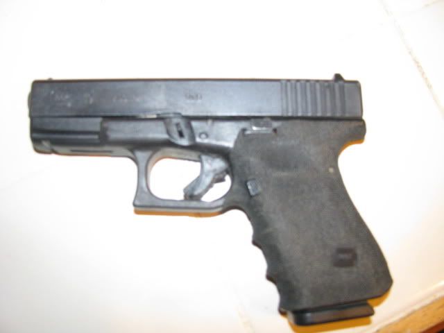

    I stippled my G19 and love it. If it's too rough you can knock the points off with sandpaper. In all honesty, if your even moderately handy, and have the nerve, it's really easy to do. And it will cost you about $20 for an adjustable tip soldering iron and a day or so to do it. One piece of advice, don't stipple above the web of the thumb. It will rub a blister if you shoot enough. And be careful going too high on the frame. I took mine all the way to the slide, and that edge was uncomfortable IWB at first. It took some work with sandpaper to get the rough spots tamed down. I will say that even when I don't get a good grip on the draw, the gun does not budge while shooting. And I don't have issues with it grabbing on my clothes either.
    I need to take a better pic.

    that looks pretty good for a DIY job. wow impressive. that said im gonna do it. going to Hatfields in Manassas, VA. ill come back on and put up pix when its finished. few weeks to drop it off and they said turn around is about 7-10 days.
