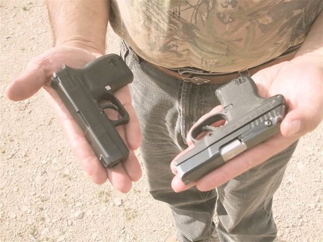

    I have a brother-in-law who bought one of the Diamondback .380s when they first hit the market. He's had excellent luck with it. I've shot it on a couple of occasions and, in side-by-side shooting tests, liked it better than either my Kel Tec P3AT or his Ruger LCP.
    I entertained the notion of trading away the P3AT for a Diamondback, mainly because the Diamondback's crummy sights were still considerably more usable than the P3AT's sights. There have been enough problems reported here on the Forum over the past couple of years concerning the Diamondback though that I'll just stick with the P3AT stinker. I don't have much need for or use for a runt .380 ACP anyway.
