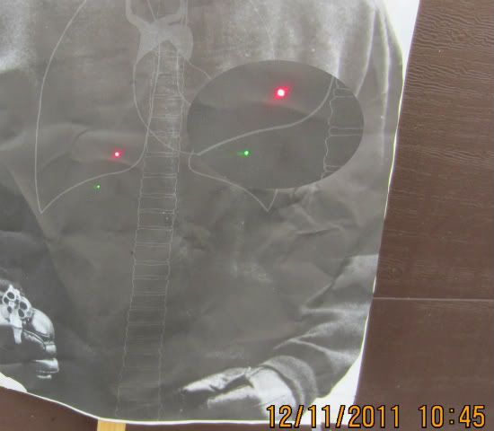

    Well this is pretty informal. I took my wife out for a deluxe breakfast, and as I drove home from Krystal, it occurred to me that it's 27 and that would be a good temperature to compare the performance of a red and green laser.
    Lighting is daylight; not full sunlight, but plenty bright. The distance from the lasers to the target is about 10 feet. The lasers and target were located in the shade so sunlight would not be heating anything up.
    Since this was a spur of the moment thing, I set up a reference, i.e. a pic just as fast as I could move the lasers from room temperature to 27 - before they could cool down significantly. My car was parked about 8 feet from the lasers, so I used it's temperature reading. It too was in the shade so the sun wouldn't be heating things up.
    Here's the temp:
    And here's what the lasers look like before 'cold' soaking:
    I should have had the dots closer together, but since this was pretty ad hoc from the start and I was using the rounded lid of a trash can as a platform....

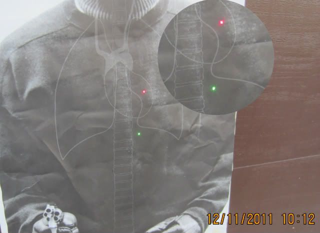

    Here's a pic at 15 minutes:
    I know, I should have had the dots closer and in the same orientation, but trying to beat the sun and temperature rise trumpted fiddling.

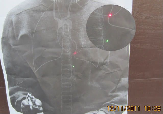

    30 min mark:
    a pic made @ 30 min, 10 feet from the target:

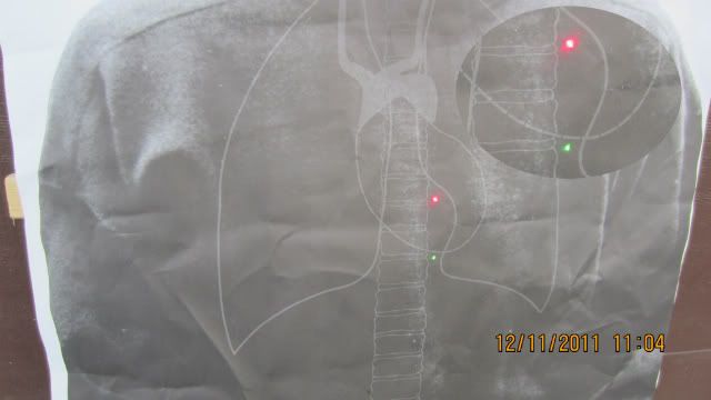

    45 min:
    1 hour:
    Well, it's pretty clear the green laser is dimmer than a red at 27. But, it didn't shut down. I didn't leave it on long enough to see if it would become sporadic, but I doubt it would because the longer it's on, the more heat generated by the powerful laser and that would offset ambient temps a bit.
    Anyway, kind of a preliminary test, FWIW.
