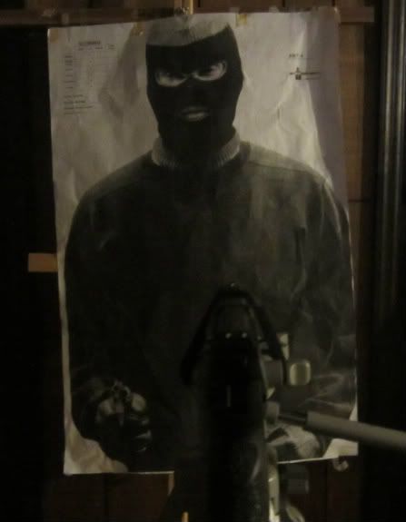

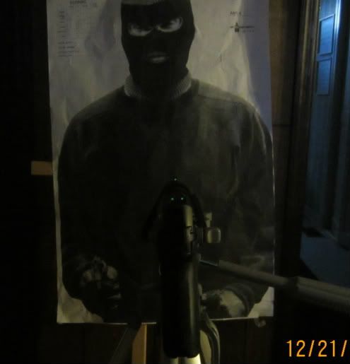

    Some updates:
    I meant to do the wake-up-and-check-the-sights every so often, but my wife had a early morning and a full, busy day and I didn't want to chance disturbing her rest with an alarm. However, I did do some things.
    1- I charged the lumies at 9:00pm and laid the P30L on top of the Sig P226R SRT with Sig Lites. The lumies put the Sig Lites to shame, as they would any other night sight, for about 20 - 30 minutes. In about 30 minutes, they were down in brightness SIGnificantly (get it - I was comparing them to a Sig - SIGnificantly - you guys don't have a sense of humor at all do you!).
    Still they were as good or better than the Sig Lites for about the next hour. So now we're out to good for about an hour and a half. And as a side bar here, it is pertinent that I also had my Sig P226R DAK with Tru-Glo TFO's on it, and the TGs were SIGnificantly (get it SIGnificantly.........awwww, never mind) brighter than the Sig Lites even though the TGs were about a year older!
    By about the end of two hours or so the Sig Lites and Lumies were about the same. By the end of about three hours they were slightly dimmer than the Sig Lites. Now, I need insert the significance of a point I've been trying to make about Tritium decay. If my Sig Lites had been about four years old instead of new, they would have been about 25% dimmer. In comparison the lumies would have been the same or brighter than the Sig Lites for 25% longer. So if they were the same for 2 hours or brighter now, in four years they'd be the same or brighter for 2.5 hours.
    By about 4 hours the lumies were at about their useful limit - not out by any means and quite visible, but considerably dimmer than the Sig Lites. You could still use them, but they wouldn't be nearly as fast.
    2- If it were just that simple - well it isn't. I'm gonna say this as conditional but provable and demonstrable. So far I've found that lumies will out perform any night sight, including TG TFOs in any lighting condition. The condition I mentioned is the illumination level of the lumies and/or any light available to charge them. Here's what I mean by all that, and it's complicated.
    First if the lumies are within an hour or so of a charge, they will beat night sights in any lighting condition. They're just brighter and bigger. In bright conditions, the lumies will absorb ambient light and glow where Tritium will not. They would be comparable, not necessarily equal to, to FO sights. In certain lighting conditions, lumies will beat Tru Glo TFOs and it isn't even close. Gonna give an example of this.
    Today I was at the range, (brought my total for the year to 11,900 rounds) shooting my Sig P226R DAK - I just love to shoot this gun; more about that in another post I haven't invented yet. it has the Tru Glo TFO sights. The same ones that were significantly brighter than the new Sig Lites. Although the range was well lit and I had fluorescent lights just behind and in front of my booth, my sights were in the shade of the booth. Neither the Tritium or the FO showed up! Not a bit! I had to shoot from the black sight profile. There's little you can do about that. If I had been shooting with lumies: if they didn't pick up ambient light, and it doesn't have to be direct light, they show up white, if they do pick up light and charge a bit, they go pale yellow. If you charge them....
    Let's say we've had our lumies under cover for 8 hours and they're discharged. It's still daylight and we draw our gun. The lumies, and Eaglebeak can corroborate this, the lumies immediately pick up the ambient light and charge. They will be bright; not necessarily green, although they may be, I've seen that happen to.
    The only condition where a night sight would prevail over a lumie is at night after the lumie has lost it's charge and then it's still conditional. The condition this time is whether you have to use a white light for threat ID. Let me say here there is a common misconception that night sights have to be used in such low light levels that you can't see your threat. Not so at all; this was shot with dim ambient room light, the threat is easily ID'd and see the night sight dots. Imagine what black sights on this would look like - we probably couldn't see them at all.
    I said that to say this, this is about the only lighting condition that night sights can beat an uncharged lumie. If it's a little darker, we'd almost have to use white light to ID the threat, especially to see what's in his hands, and then any sight would show up. And if it's a little lighter than the above, the Tritium won't show up and the uncharged lumies might show up as white. In fact here is a shot of the lumies in the exact lighting conditions. The lumies have been in my completely dark safe for 8 hours. I removed them in the dark, put them under my vest and set the gun up in the same lighting conditions. Here's what the uncharged lumies look like - uncharged lumies.
    The white dots are clearly there; not quite as bright as the Tru Glo's but clearly more visible than all black sights.
    And lastly I'll add, what if the Tru Glo tritium was 4 years old? They'd be 25% dimmer. But, and I think this is big, we don't know how age affects lumies, well, at least I don't.
    Just what I've found so far. And note that not everyone will get the same results necessarily. Nor should any of this be used to draw hard conclusions from.

    I wouldn't jump just yet; all my findings are quite preliminary. Remember, this is all new to me and I'm still learning. We/I need to eval them in a lot of situations.
    You hit one of the main issues squarely - when we start talking low light, we need white light to discern a cell phone from a gun in someone's hand. For cases like the hooded BG in my pics we know we have a BG, but generally it's more complicated than that and we need positive verification that the threat is or is not a threat and in what way he is a threat. That principle all but eliminates the low/very low light level issue for uncharged lumies. If we use white light, sights aren't an issue.
    And you'll have to think along with me on this, the two heads better than one thing: In the higher levels of illumination, we don't have a threat ID problem, we have a 'can I see my sights against his dark clothing' and how quickly can I pick up the front sight. That to me is where the lumies shine, pun intended.
    But I'm still in the eval mode. It would sure be good if you and others could get some and eval them.
