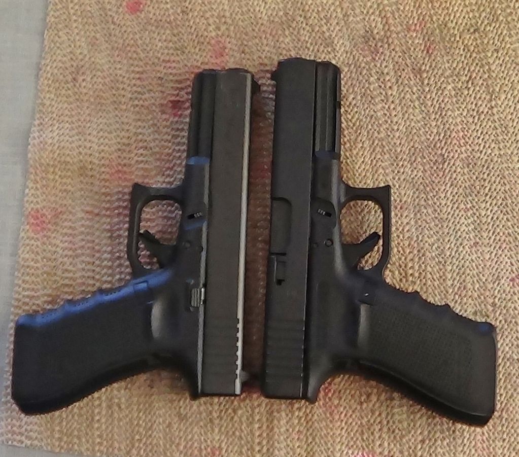

    The G21 gen 4 is a .45 ACP. It’s a pretty big gun, yet it isn’t. Here it is in my hand; notice my little finger is right at the bottom edge of the grip and I do apologize for the big pics. Honestly, I just got lazy, or tired, and didn't want to resize every pic:
    Then here it is beside a G17 Gen 4.
    You know what the extra length is? It’s essentially the difference in the length of a 9mm round and a .45 ACP round. Notice the barrel hood is where the extra length is. You have to look carefully or you’ll miss it. Notice especially the muzzle ends of the barrels – they’re even. If you move rearward to the FRONT of the ejection port, they’re even. If you then move to the REAR of the ejection port, you’ll see where the extra length is – the length of the barrel hood and/or chamber.

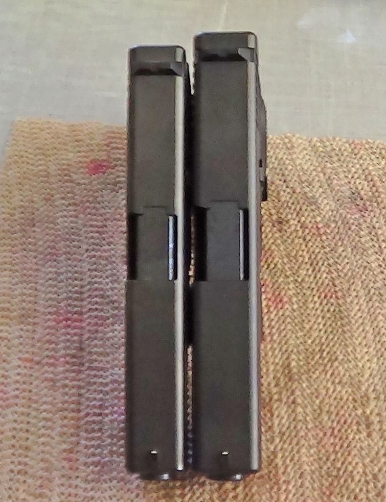

    The G21 is a bit wider. The slide of a G17 Gen 4 is 1.003”. The slide of a G21 Gen 4 is 1.125” – about an 1/8” wider. The grip width of a G17 is about 1.183”. The G21 grip width is 1.269” – a surprising 0.086” difference. I say surprising because that’s just about 0.025” over a 1/16”!
    The trigger reach (gen 4) is 2.75” on the G17 and 2.86” on the G21 – a difference of 0.11” – that’s kind of significant.

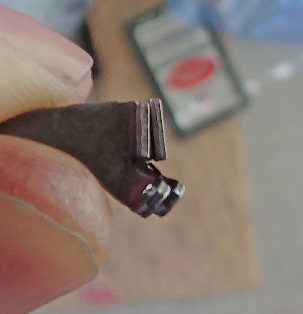

    Theories and rumors abound, but I have yet to hear from a Glock armorer or any dependable authority that knows why Glock went to the dot connector. One theory was that in reducing the grip, the angle of the trigger housing had to be changed slightly. That would change the angle of the connector ramp relationship to the trigger bar and make the trigger heavier. So Glock compensated with the ‘dot’ connector. I checked out all that on a gen 4 and gen 3 and could see no difference in the angle of the trigger housing. If it’s there it’s too subtle for me to see.
    Another theory is that for some reason, Glock changed the trigger bar profile where it contacts the connector and this made the trigger heavier, and again, purportedly Glock went to the dot connector to compensate. Well, again, I checked my gen 3 trigger bars (I had a bunch of trigger bars lying around that I experiment with) against my gen 4 trigger bars and can see no difference in the profile.
    On top of my observations, I talked to both Oliver and Arthur of Ghost Inc and neither knew why Glock went to the dot connector. Although, they did say that they had observed that some gen 4 trigger bars did have a different profile. It seemed to be just the ones with the serrated trigger – it’s not really serrated, but it’s not the smooth trigger. Moreover, they have seen that both their 5# and 3.5# give the same trigger pull weights in a gen 4 that they do in a gen 3.
    It makes no sense to me that Glock would change the trigger bar profile and then have to make a new connector to make up the difference. Why not just go back to the original profile and be done with it. Soooo….here’s my new theory…
    Glock went to the dot connector to LIGHTEN the trigger! This really makes more sense than anything. See, I’ve been telling you all along that Glock triggers are too heavy! Now, look at you, all upset again.
    Here’s a picture of the two connectors with one on top of the other:
    What you want to look carefully at is the ramps on the connectors. The ramps are at the top of the connector, close to the center of the pic. Notice the slight change in angles. The angle of the ramp on the dot connector is in a direction that will lighten the trigger pull weight and it does – I know it does because I measured the stock 5.5# connector and dot connector in the same gun, the G21, and the dot measures lighter.
    I did a number of trigger pulls and used the average. Glocks are the hardest guns on earth to measure trigger pull weight. Ghost Inc says the same thing. Here’s 45 seconds showing how I do it:
    And here’s the results (that I got):
    Std. 5.5# Glock connector: avg = 6 lbs-6.5 oz
    Dot Glock connector………: avg = 5 lbs 13.5 oz
    Ghost Rocket connector...: avg = 5 lbs 11 oz
    Isn’t it interesting that Glock has lowered the trigger weight pull!!!!

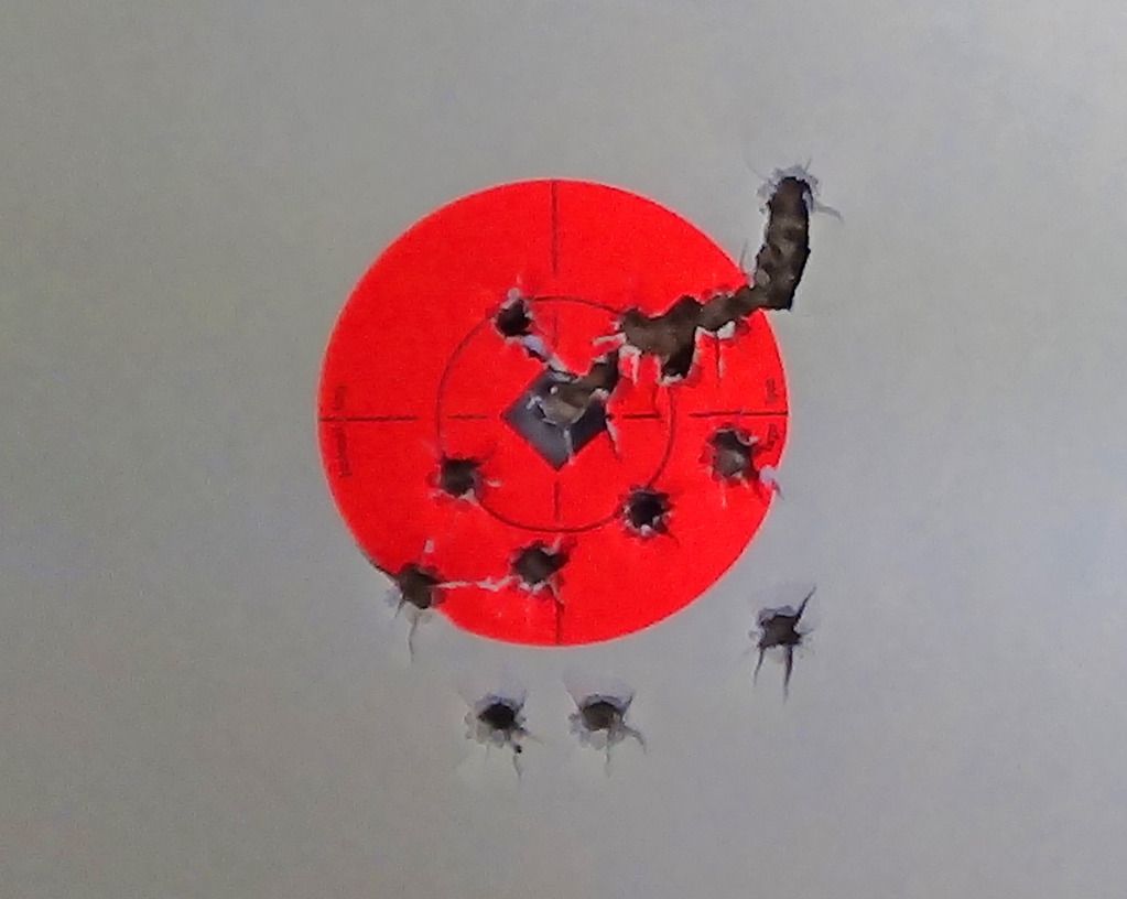

    OK, here’s the shooting. I’ve modified my standard drill from 5 shots each at 3, 5, 7, 10, 15 yds to 4 shots at each range. That uses 20 rounds. That leaves me with 30 rounds which I then shoot three 5 shot groups of rapid fire at 5 yds at two 3” dots. That totals 50 rounds, or a box of ammo and I’m only dropping one round per range in the slow fire. I think it’s a win-win. So here’s the two slow fire targets, not my best, but it is what it is. This is the 3, 5, 7, 10, & 15 yd shots. The pics are after all ranges have been shot. I shot the drills twice, hence 100 rounds.

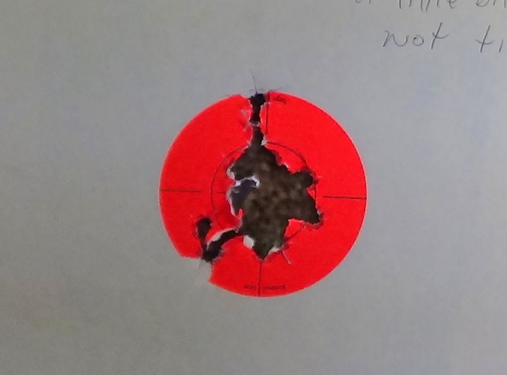

    And the second,

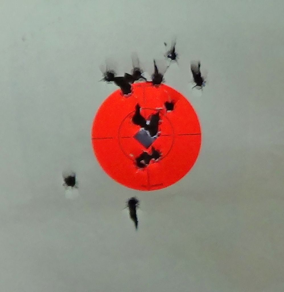

    Then the rapid fire, although it wasn’t as rapid as I would have liked. Well, these first two were and as you can see, I didn’t stay on the 3” orange dot all that well – 15 shots per dot.
    And the second,

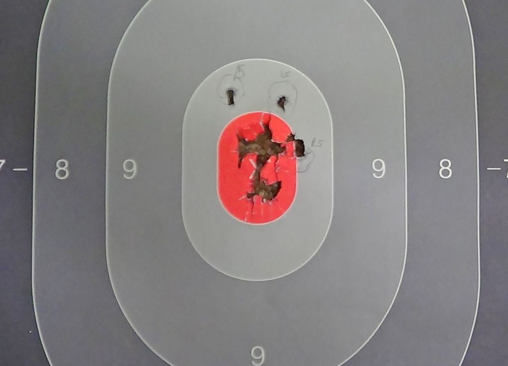

    Well it looks like I need to slow down a bit and quit worrying about pushing the envelop and hit the target:
    And the second,
