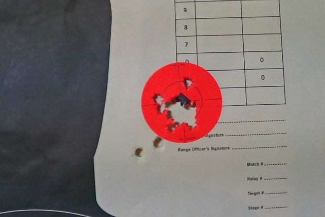

    Here's the slow fire eval drill - this was actually the second drill; I'll get to the first after this:
    Let me explain about the three misses. They occurred at 15 yds, so we would expect a larger group. But, the two shots to the right are too much. As I continued shooting, I realized I wasn't doing so well. I then noticed the sight had worked loose. I think the two shots to the right were the beginning of the sight loosening.
    The sight coming loose was my fault entirely. I did not use thread lock as recommended because I wanted to get 100 rounds through it before I locked it down. I thought it would take more than 100 rounds to loosen. So that concluded the testing.
    However, the first eval drill was rapid fire at a 3" dot at 5 yds. Since this was a first effort, I didn't time the splits, but I was rolling.
    At this point, I believe the sight was still mounted securely. This is 30 rounds fired in 5 shot strings. The first 4 shots were inside the 1" ring. Then of course, as usual, I got over confident and lost my head for a shot or two.
    Even so, you can see the main group is quite tight with only two misses and maybe two shots slightly apart from the main group. Remember, this is rapid fire - I wasn't maxed out, but I was going fast.
    I had no trouble losing or re-acquiring the sight in recoil, although I have to attribute a bunch of that to technique - the gun just didn't jump enough to cause a problem. Although I did lose the dot a couple of times.
    All and all I'm impressed. I want to be careful this wasn't 'beginner's luck' though before I come to any hard conclusions.
    At this point I will say, the dovetail mount isn't all that bad. You won't have co-witnessing sights, but you won't have spent $700 - $800 to try a RDS either. And your slide won't have a big block machined out of it if you decide to go back to iron sights or a different RDS.
