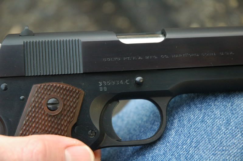

    The Series 70 was actually a two part system; it was a collet bushing and the "Accurizor" barrel. Colt first used the collet bushing and the accurizor barrels on "commercial" Government Models built in early 1970 (serial number range 332500-C through 336169-C), they are known to collectors as the BB Transitionals. BB was struck under the serial number, representing the use of the new Barrel and Bushing. The actual pistols rollmarked "Mk IV/Series 70" were introduced in July of 1970.
