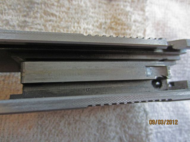

    Next I discover the tool marks on the slide - on the bottom edges of the slide, the center of the slide where the disconnector and hammer ride, and beside that center point. The next thing I check is for the chamfer at the bottom of the breach face - it was barely there if at all.
    I had noticed a scraping sensation when I racked the slide and I was looking for the cause of that as well. I discovered what it was: The spring scraping on the guide rod. Upon examination, I could feel the roughness and diameter irregularities in the guide rod. It was subtle; you could feel it more than see it.

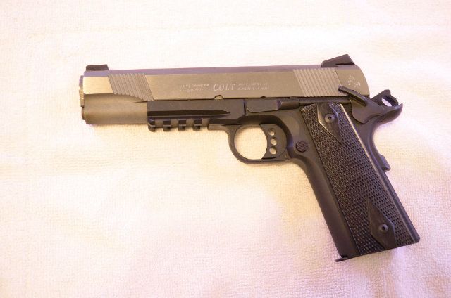

    The pic really doesn't do it justice. I'm usually not drawn to two-tones at all and if I'd had my druthers, I would have taken an all black version. But this one was eye catching. The stainless steel (SS) slide is brushed and gives a really sharp contrast to the really black frame. So I selected the Colt TT rail gun; they did the paper work and I headed home really pleased with the outcome and especially that Benton's not only gave me full credit for the TRP, but did it very willingly. Just outstanding customer service!

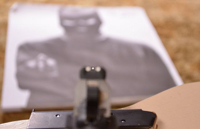

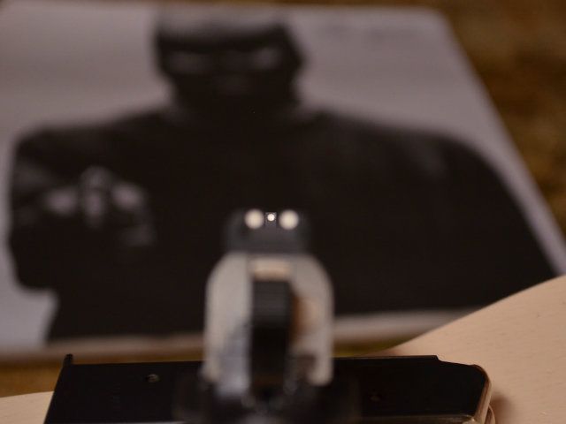

    The gun comes with very bright white (not night sights) three dot sights and they are quite visible. Here's a couple of pics, one in bright room light and the other in much less light. That wasn't easy to get those sights lined up and the focus on the front sight!
    The slide is stainless steel with front serrations, which I prefer, the frame is carbon steel finished in a very dark matte black finish. It doesn't have front strap checkering and I really prefer that on a SD gun. The main spring housing (MSH) is plastic and Colt has been using plastic I know for about 20 years now. And it comes with ambi-thumb safeties.

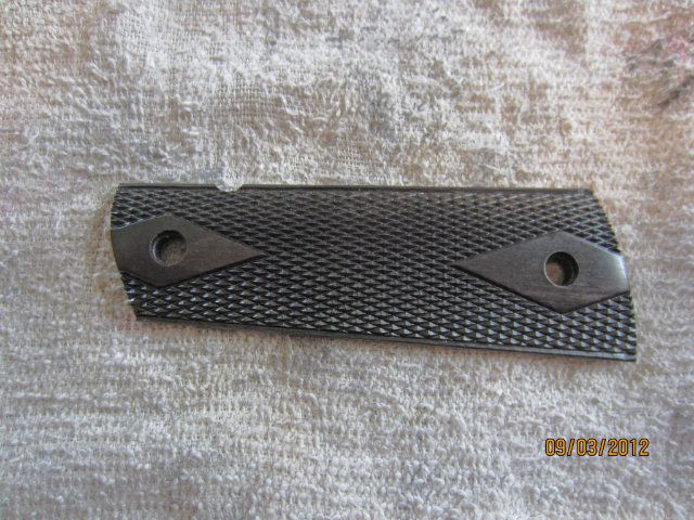

    But a look at the back side reveals the grips are wood - notice the splintering around the holes:
    So I do the 32 miles back home (probably in record time); broke the gun down and cleaned and lubed it. Off to Shooter's Depot to run 200 rounds through it. Simply put - it shoots!

    Let's start with the slide, since that's the first thing that comes off. Here's what I found. Notice on the bottom of both slide rails, the center of the slide where the hammer and disconnector ride, and right beside the center of the slide. These are not serious issues, and IMO, would not affect reliability. You just wouldn't expect that to be there.
    Also (not shown in a pic) the front of the slide had the sand blasted look on a short portion of the rail - that shouldn't have been there. It wasn't on the other brand.

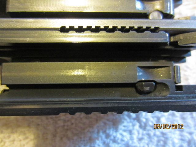

    In fact, here is a pic of another brand of 1911 - completely stock. The black (or darker) slide is the other brand. Notice the complete absence of tool marks - anywhere!:

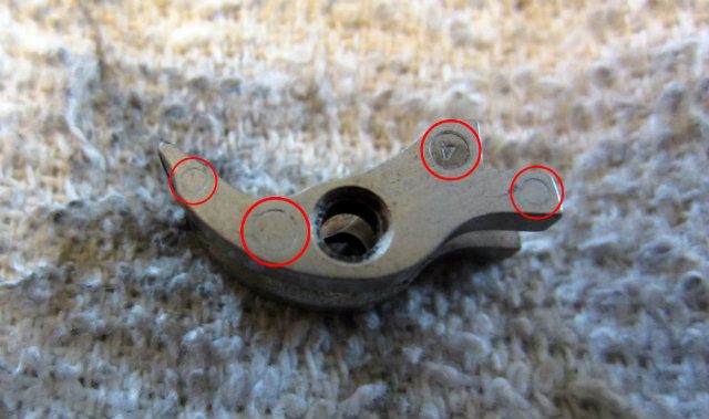

    Ok, so let's go a bit further: Here's a pic of a beautifully finished disconnector. I have seen total disasters in disconnector fabrication in S&W and SA 1911s, but this one is nice!
    Notice what appears to be casting marks:
    Here's the sear, again notice the casting marks:

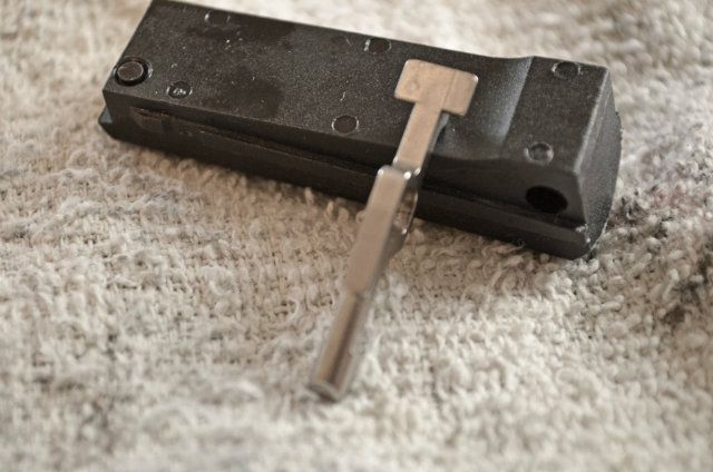

    Here's the beavertail, again notice the casting mark inside the piece and a larger one at the top of the piece:

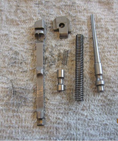

    Here are some small parts - all are nicely machined and finished.

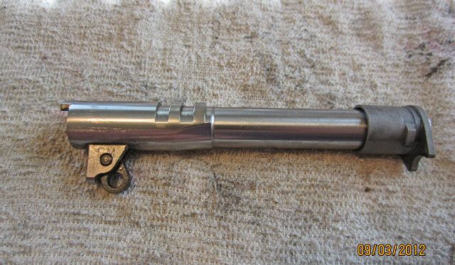

    And finally a beautifully machined and finished SS barrel:

    Tangle, on the current standard Colt's, there are four MIM parts;
    MIM
    sear
    disconnector
    magazine catch
    magazine catch lock
    CAST
    Thumb safety
    grip safety
    FORGED
    slide
    receiver
    barrel
    slide stop
    MACHINED from bar stock
    hammer
    all pins
    bbl link
    bbl bushing
    trigger finger piece
    ejector
    firing pin
    firing pin stop
    extractor
    plunger tube
    It appears the grip safety is too, I haven't even had mine down yet. I did replace the ambi-safety, I don't who the vendor is, but I hate the "unfinished" rear edges. As far as the recoil spring, they've been using the 15-16# springs for years now.

    Good honest review. I'd just "stone" the disconnector run. The bevel at the base of the breech face is perfect.
    Typically the bottom faces of the slide rails do not actually contact the frame which is why there are usually always some machine chatter marks there.
    The slide usually runs on the frame rail and the condition of the bottom faces of the slide are usually irrelevant unless the slide has been custom tightened, lowered, and fit to the frame.
    The mainspring housing I would (of course) swap out. The grips look like Macassar Ebony. Pretty nice actually.
    None of my Colt triggers have overtravel screws. I think they are more of a P.I.T.A. than they are worth unless it's adjusted correctly and then set with Loc-Tite so that it will never again move.
    The Grip Safety always cast. and not a problem.
    The cast internals...well, you already know how I feel about those no matter what "brand" of 1911 they are found in but, the vast majority of shooters keep them and never have a problem.

    Quote Originally Posted by Tangle View Post
    Yeah, you can do that with cast.
    I'm pretty sure the other slide is machined. Hmmm, I'll have to look into that.
    I was kiddin' ya.
    Although, my CRG doesn't have as pronounced tool markings, it does have some, even my Baers have some very light ones.

    I was kiddin' ya.
    Ah man, you got me!
    Actually the other slide is a Kimber. To tell the truth, I don't know if it's machined, forged, or cast???? For some reason that escapes me at the moment, I've always thought it was machined, but now I don't know why I think that.
