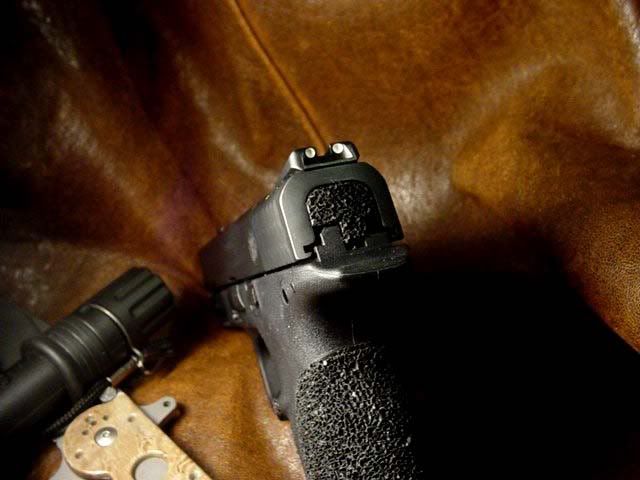

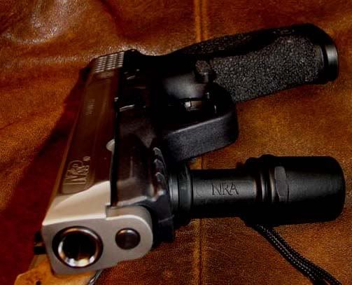

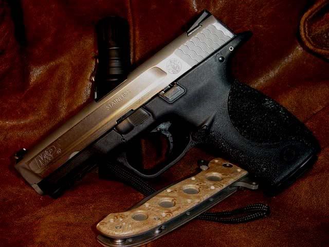

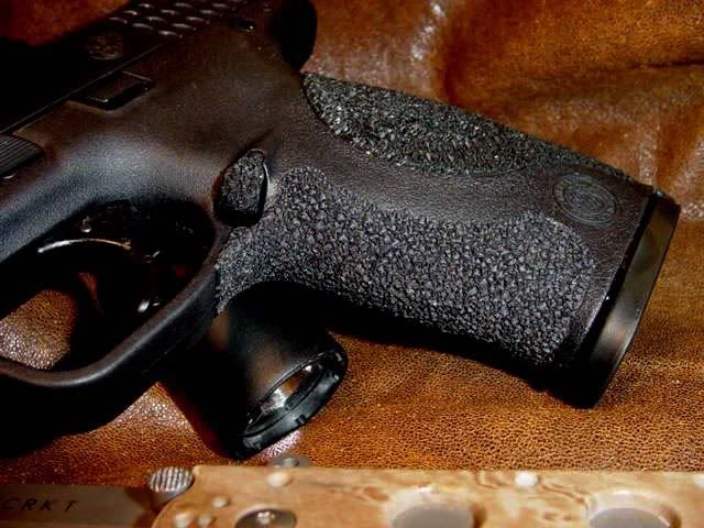

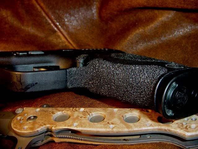

    I have just started working on the S&W M&P and am very favorably impressed with these pistols. This one belongs to one of my very good customers. It has trigger and reliability work and the custom texturing or stippling on the front and rear strap. I will be taking the slide to the shop today to give it a minor "melt" and media blast it for a two tone look. The slide on the M&P is stainless, so a nice satin media blast will look very nice. Anyway, the trigger on these can be set for as light as 3 lbs and very crisp along with removing the mag disconnect. Anway, here are the pics of the stippling. Another gunsmith friend of mine, Dan Burwell, does a sharkskin and stippled look, this is more of a honey comb look. I like this because it resembles the pattern that I do on the metal stippling, more of a random pattern with not much repeating in the pattern. You will notice that I have even textured the rear of the slide and the mag release as well. When I have it apart to do the trigger work, I will also give the trigger a light texturing as well.
    The texturing appears to be a bit courser in the pics than it looks. It really does match the balance and factory look while it REALLY improves the comfort and is a huge improvement on the grips. Almost like velcro! I will also be offering trigger work on the Springfield XD with similar grip texturing and reshaping, along with trigger work. I am working on my personal XD-45 right now. I have the trigger pull down to a very crisp 3.5 lbs with an adjustable trigger pre-travel adjustment. And I will be removing the front strap checkering to slim and re-profile the grip a bit and the doing this stippling on the side panels and front strap of the XD. I can also do grip reduction on the other caliber XDs, but not the .45. The grip material is just too thin to reduce very much. I can really do this to any polymer pistol, such as the Glocks and others. Just depends on what the customer wants!

    Yes the stippling is done with a soldering iron, but I would like to think that there is some talent involved with making turn out nice. There is quite a bit involved with the amount of heat that is used, how long it is applied and what you do with the pattern to make it look right. I have seen a LOT of stippling on the internet that obviously looks like it was done with a soldering iron. And there are some that look pretty dang nice too. It does take some patience and practice to get it to look right. If you look at the DYI stippling section on my website, you get a very good idea of how this is done, just substitute a soldering iron for the punches. And I use a temperature controlled iron. There is a bit of a difference in the plastics that are used by the different gun makers and some temps work very well on some guns that would burn a hole right through some of the others. The nice thing about the S&W is that if you do make a mistake on the back panel, you can just get a new one. Not the case with the XDs or Glocks. It has to be right the first time.

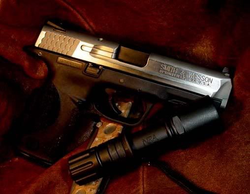

    Decided that I was not done with this one yet. Since the last pics, I have refined the trigger to a very crisp 3.5 lb match trigger. The owner mainly uses this gun for matches and range use, but this trigger is still not so light that I don't think it could be carried. It could be. I media blasted the slide, did a slight melt on the front for easier holstering and carry, and then did an old fashioned 320 grit hand polish on the slide flats. Then added a 45 degree polished target crown. It makes for a very striking custom look to the gun and a totally different character. The slide of the M&P is stainless, so there is no problems with taking off the black finish. Here are the pics. I will have a hard time shipping this one back, I like it that much!
