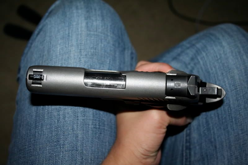

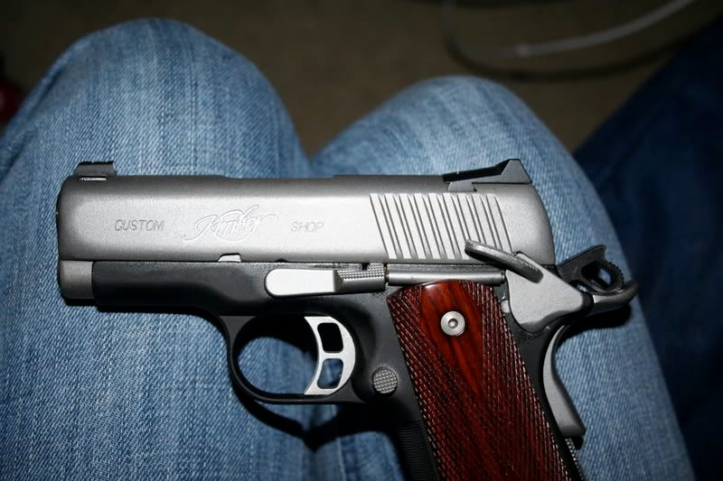

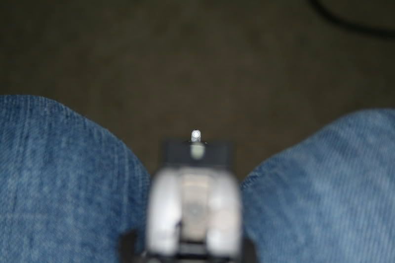

    Picture time....
    Rear sight...
    Front sight...
    Side...
    Top...
    You can see that the rear sight is more slanted forward (toward the muzzle) than traditional sights. I'm still up in the air as to whether this is better or not. I'll tell you tomorrow after I shoot it more.
    However, I DO like the "V" shaped slop instead of the hard lines that usually go on either side of the front sight when you are aligning the sights.
    It helps allow faster front sight acquisition as the front sight does not get blocked by the rear.
    Overall, so far, very pleased, but the real test will come tomorrow when I actually shoot it.

    Very nice. I can see why it would give you faster sight picture and decreased precision.

    Two and a half hours later and three strong men later, they were finally on.
    Pssst! Lima! If you use a triangular file on the slope cuts, and a light stoning across the bottom of the sights to make sure there are no ridges, they go on much easier and still stay in place. (I about broke a Glock sight tool before I learned this)
    I'm a big fan of the Dot too. Actually, I think you got the better deal, with the Standard- it will give you slightly more "accuracy", until you build your speed and confidence. When I transitioned from Standard to Big dots, my first thought was, "Jeez! This thing is HUGE!". Couple of mags late, no noticible difference.

    If only you could see how much filing we did.. That's what took up most of those two and a half hours!!
