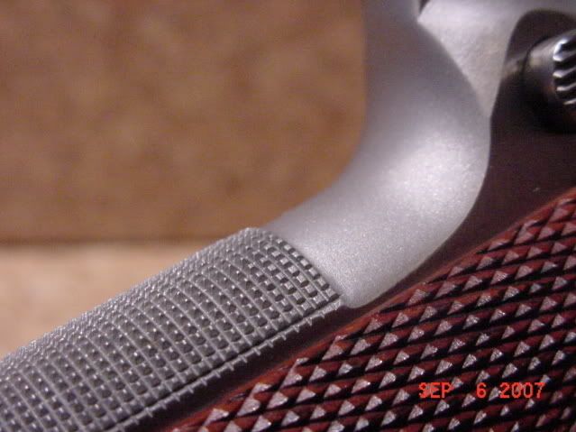

    Quote Originally Posted by Catalina View Post
    I've seen this on many gunsmiths websites... What exactly is it? any before and after examples?
    It's way too late to post pics, but basically the curve, for lack of a better word, between the top of the frontstrap and the rear-most portion of the trigger guard is eliminated. Different 'smiths make the cut differently...sometimes it's just a gentle adjustment, and sometimes your middle finger can almost get stuck in the cut because it goes into the frontstrap so deeply. On my DW CBOB, the factory 25 lpi checkering now appears to be a raised surface, because the metal above the checkering pattern has been removed.
    The reason for this is purely personal preference, but like a beavertail grip safety, it allows for a higher grip...thereby lowering the bore axis which should allow for a more controlable gun.
    Besides that, it just feels cool.
    Until I can get some sleep and some more time to post pics, go to the Nighthawk Custom site and check out the "curve" from the rear-most portion of the trigger guard to the frontstrap on the GRP line and the Predator line. The Predator has a high-cut frontstrap...or undercut trigger guard. You decide which term to use.

    Here's a quick pic of my high-cut frontstrap, or my undercut trigger guard. Notice the flat surface behind the trigger guard, and how the checkering on the frontstrap appears to be a raised surface.
