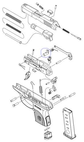

    Member Array razz's Avatar
    159
    The part that is broken on the picture is the part circled in blue on the above diagram.
    Off Of The X
    32,289
    Looks like a MIM part to me.
    Even an investment cast part would not snap off like that.
    It's part of the transfer system but, it's not under That Much stress.
    I'm calling it a defective Metal Injected Molded part.

    2,342
    Have to admit, that was my first thought too.
