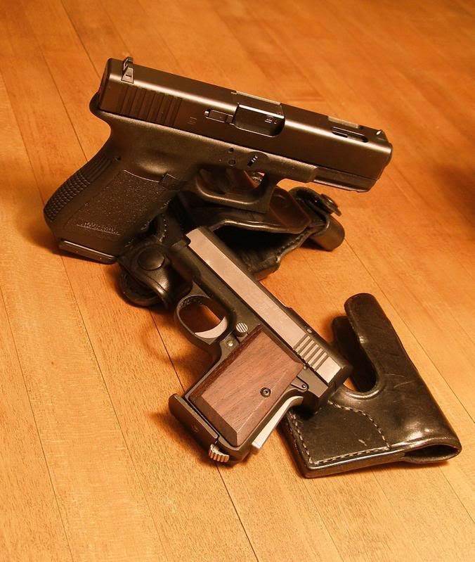

    Wheeler Engineering makes a product called CERAMACOAT, get it from midway. You degrease (I used brakeclean) and spray paint. Then bake it in the oven for 30 minutes... Did this about 4 years ago, carried almost daily and has one small scratch so far... the finish is hard as nails and durable.. no chiping, flaking or peeling... Even where the detent ball rides on the frame for the safety is not wearing yet, and I put at least a mag or two through this every month. I would take the base plate off the mag (don't want to bake the spring or follower) and it would work well. I did one mag base on this AMT .380 backup as well: it is aluminum, still holding up, but that is where the scratch is...
    Pic with the steel mag base in the gun, aluminum base plate out...
    Pic with the cerama coated aluminum base plate..along side the G23c BEFORE I put real sights on it... Now it is sporting some Heinie straight eights.
