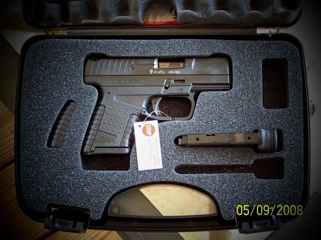

    Walther replaced the PPS with the 9mm (and 40cal) PPS. The PPS (Police Pistol Slim) has been on the market since late last year (2007), but is still a bit difficult to find in most markets.
    I have owned a PPS since January. My first PPS was a very early series (14XX) and had ejector problems. It was replaced by S&W (who does the warranty work for Walther on this model) with a new one in the 41XX range, and this replacement PPS has been fine.
    The PPS is extremely THIN, and I should think lighter than the old PPK.
    I am not "anti-PPK" as I think the design is a classic, and the pistol is beautiful.. But, the PPK was prone to bite the hand that shot it, the DA trigger pull was heavy, and a lot of them were ammo sensitive. Apparently if you got a "good"PPK, it was good forever, but if you got a PPK with problems, it had problems forever.
    So, sadly for PPK fans no 9mm PPK's will be coming down the pike.
    I do recommend the Walther PPS.. It's an ugly little sucker (especially when compared to the classic looks of the original PPK's), but it does the job, and conceals quite easily.
