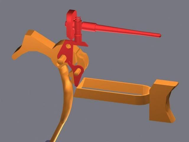

    The single biggest change to the 1911 design came about in 1983, when Colt introduced the "MK IV Series 80" pistols. These guns incorporated a new firing pin block safety system, where a series of internal levers and a plunger positively blocked the firing pin from moving until the trigger was pressed, thus eliminating the possibility of the gun discharging if dropped onto a hard surface or struck hard. In this instance however, ALL of Colt's 1911-pattern pistols incorporated the new design change so even the Commander and Officer's ACP pistols became known as Series 80 guns. With the previous paragraph in mind, it is important to know that from 1983 until 1988 the early Government Model and Gold Cup Series 80 pistols used the Series 70-type barrel and bushing as well, although they were known only as Series 80 guns.

    You're welcome. No real reason not to get a Series 80, they have 4 additional parts which makes reassembling from a detail strip take a little more time.
    Some will claim the additional parts cause the pistols to have bad triggers, I don't find it to be true, I have have both 70s & 80s and trigger pulls run from 4lbs. to 5.5lbs on the Series 80s.
