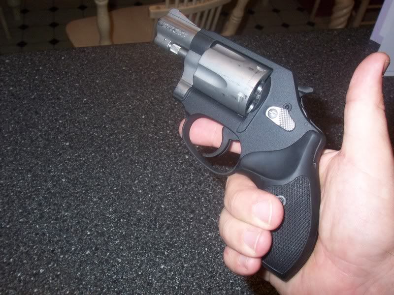

    Just bob that hammer and throw on some duracoat in flat black. No finish worries now other than the cylinder wear from my kydex holster. Its not pretty, but effective.

    Quote Originally Posted by mhm2a View Post
    Wow that looks GREAT! Who did the work??

    I did the duracaot myself. It turned out very well and has held up so far ( only a couple of months) Just get the duracoat kit and follow the directions. It will make you want to duracoat everything you own. Well almost everything.
