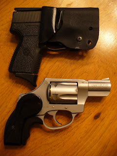

    The requirements for a firearm to be a S&G gun may vary from person to person based on hand size, recoil sensitivity, body type and caliber preference. The fundamental characteristics will typically be small size & light weight to maximize comfort & concealment ability. The guns I am going to use in this comparison I've found to meet all of these requirements (after a little tweaking). The semi-auto is a Kahr PM9. The PM9 is uniquely suited for concealed carry because of it's amazing measurements and weight for a subcompact 9mm with 6+1 capacity. The revolver is a Charter Arms Undercover .38 special in double action only (DAO). This Undercover isn't the lightest offering by CA, but the extra ounces translate into less recoil & better control when shooting +P ammo.
    Here's a direct comparison by the numbers:
    -----------------Kahr PM9------Charter Arms Undercover .38
    Length-------------5.6"---------------------6.31"
    Height-------------4.3"---------------------4.5"
    Width--------------1.1"--------------------1.25"
    Carry Weight-----20.8 oz-----------------19.2 oz
    Caliber------------9mm------------------.38 spl +P
    Capacity-----------6+1----------------------5
    Note: Carry weight takes into account everything needed to carry the gun in S&G condition. That means loaded with whatever carry grips or holster needed.
    As you can see the semi's smaller in every dimension, but the revolver's lighter and in true revolver fashion because of it's rounded shape the extra tenths of an inch don't inhibit it's concealability. Neither of these guns comes out of the box ready for S&G carry since on the standard gun there's nothing to keep it from sliding down the waistband. Here's how I solved that problem and also what I added to aid in shooting comfort.

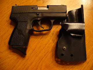

    The Semi Automatic
    Some of you may see this picture and wonder why I choose to use a holster with this gun instead of going with something similar to the Barami Hip Grip such as the Covert Carrier. The reason I feel like a holster is necessary with this gun is because of how light the Kahr's trigger is at a little over 6 lbs. Although the pull is longer than any single action trigger it is noticeably shorter than that of the revolver. Because of both of these facts I don't feel comfortable carrying it without the trigger covered hence the holster. The holster is a homemade kydex one I pieced together from a previous holster I'd made. I integrated the clip into the holster to make it as thin as possible and it works. The clip works to stay attached to the waistband by catching it on the draw. The waistband must be fairly snug for it to work properly, but I don't like my shorts sagging so that's not an issue. For added comfort I added a Pearce Grip Extension to the magazine bottom which allows my whole hand to wrap around the grip.
