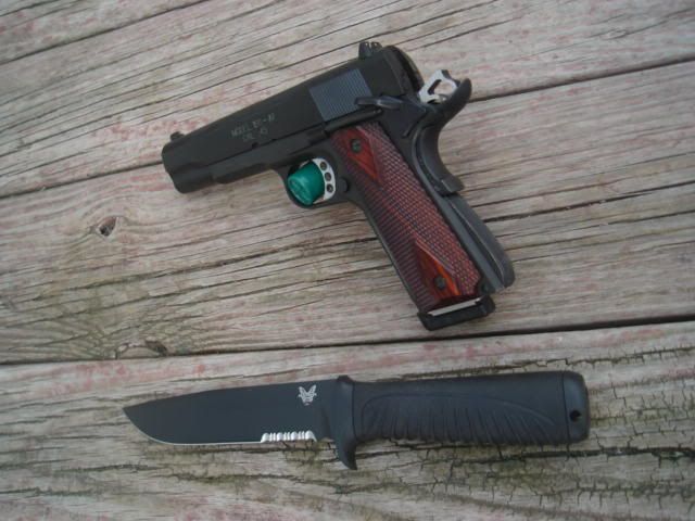

    I have carried both a full size SA Mil-Spec and Champion for years
    (18). Have had 0 malfunctions with the full size with any ammo I fed it and carried it for 16 years till I found the Champ. My Champion had a few FTFs and occasional FTE with JHP's and was ejecting the last round straight in the middle of my forehead. Sent it back to SA and they replaced/tuned the ejector, throated the barrel and polished the feed ramp and barrel. After that she was good to go. Carried it for 2 years till the cost of .45 was too much to get in a weekly practice session. Am now carrying a BHP and am extremely pleased with it, and the ammo is much more affordable and holds an extra 6 rounds per mag. Now let's talk Kimbers. Do alot of IPSC and IDP matches. Saw 3 full size Kimbers which I cannot remember the models give their owners fit's. FTF's, FTE were the big problem. 2 of the three were sent back to Kimber for repair and still had the same problems. The other gent sold his and bought a SA. Can't say all Kimbers are bad as have heard great things about them, but from my experiences I would not buy one. My SA's are now my bedside and truck partners. JMO.
    SA Mil-Spec
    SA Champion
