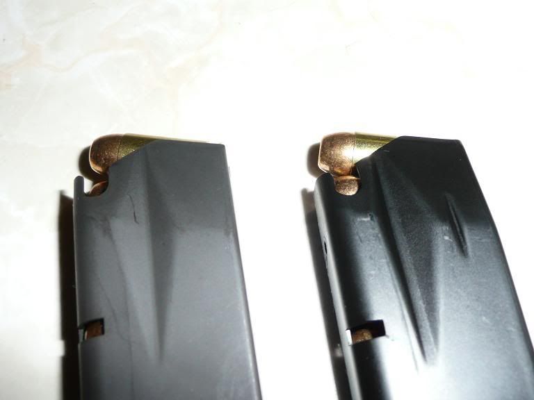

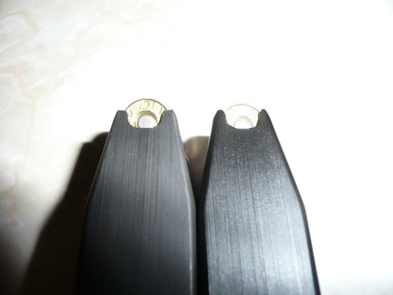

    Take a look at these pics; the mag on the right is a 13 round mec gar, while the matte finish is a 12 round OEM mec gar mag that came w/ my 226.
    ...notice how the lips are a tad bit wider on the OEM mag?
    That slightly wider opening may not hold 9mm in place reliably (unfortunately I don't have any 9mm ammo; these are loaded w/ 40).
    So keep in mind that you may have to buy 9mm mags as well.
