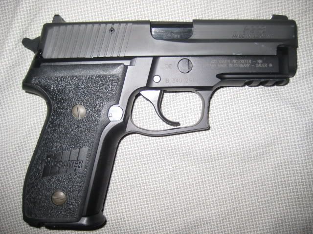

    I finally decided that a sig would be my best bet for a duty gun. I haven't been happy with the issued glocks and I ended up getting a really good deal on this sig.
    I was stuck between it and an HK P30. The double action on the P30 felt better, but the Sig had better sights and more aftermarket sights available. My FFL said if I got the Sig he would do some trigger work on it so I decided to go for it. About an hour after purchase it was done.
    We tested mine out of the box with a lyman trigger gauge ( 5 pulls for each action and took the average). Double action tested in at 11 pounds 5.5 ounces and single came in at 6 pounds .5 ounces. We put a 17 pound main spring and polished some of the parts and got it down to about 9 pounds 9 ounces double (and it felt smooth) and 5 pounds 5 ounces single.
    Its accurate as any sig should be and now that the double action is smooth as butter I am just as accurate with that as I am in single action. Now just to decide what sights I want. Here are some pics (I am not much of a photog anyway):

    I like it... looks like an exceptional carry gun...

    man, whats with that grip? I've never seen one so worn down like that!

    This one is special. I just started selling Sig's but can't get this model. It is not made in the U.S.A. and is not listed in any of my catalogs or databases. As for trigger jobs. Your smith knows his stuff. Know what happens when you polish it more? The only thing I would question is why you did not have the hammer bobbed to avoid snags.
    Hang on to it . the are not many like it . This one is is I believe Swiss made, not German as Someone mentioned.
    Most Sig's in the US are manufactured in New Hampshire but not the 228 model.

    I shoot high thumb and the pattern on the grips was very uncomfortable, so I alleviated the part that rubbed the worst.
    As for SigP250's question, I didn't bob the hammer for carry because its main purpose it a duty gun, and I have never had a problem snagging the small sig hammer on anything, especially when concealing it.

    I think that may just be a smudge on the photo . . . I hope so anyway.
    OOOPS! I missed the part where he explained the grip . . . disregard!

    I did check with Sig Sauer. This model is an older limited edition pistol. It was Swiss designed. Some were imported to the U.S and
    manufactured in Germany. Some were actually made at Sig Sauer in New Hampshire. There is nothing that makes this 9mm superior to any other Sig's except for collector value and the love that one may have for a particular Sig model.
    This one is a keeper. ENJOY!
