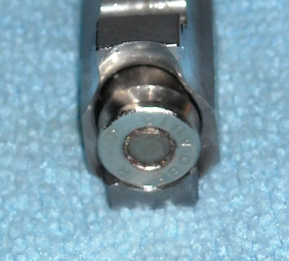

    Also, another thing to consider is that the LCP leaves a rather large section of the case unsupported by the chamber. Here is a photo of my LCP barrel with a cartridge:
    With that much unsupported case, I'm not putting any of the "hot" stuff in mine. I like my fingers.
