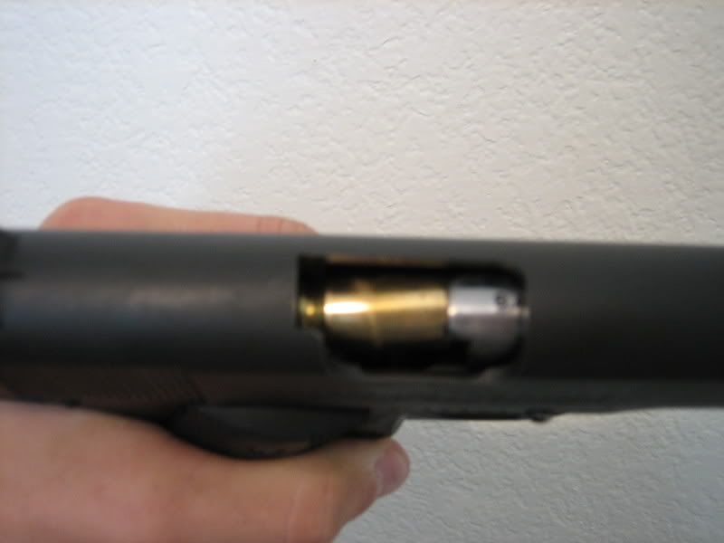

    Howdy all. I've had my Springfield GI since Oct. and haven't had any problems with it at all. This weekend, that changed.
    I fired 100 rounds out of the pistol and had 4 FTE with 2 different magazines that have worked great in the past. Ammo was 50 rounds, CCI Blazer Brass and 50 rounds American Eagle.
    The first two malfunctions occured with a Chip McCormick mag, but they were not what I wopuld consider mag related jams. The cartridge was fired, but was still held in place by the extractor with the case mouth jammed against the barrel at an angle. About 5 shotsd later, I had the same incident happen again.
    I changed over to a Kimber magazine and resumed firing. It happened twice more.
    I tried to recreate what I saw after I got back home so I could take a picture. This is about as close to what I saw as I could get.
    My extractor has been tuned, and I don't really think it has anything to do with the magazines. There is no shock buffer, and the recoil spring is the factory original. I spoke to my gunsmith and he wants to spend 5 minutes polishing the chamber since he believes the casing may be getting hung up while leaving the barrel.
    I was shooting good groups in a weaver stance, and do not believe it was limp wristing.
    Do ya'll have any ideas?

    It looks like the slide was not moving back far enough to positively engage the casing with the ejector, or perhaps the ejector is worn or damaged?
    Your smith could well be right, too, that the chamber is a bit tight or rough and that is holding the casing up from proper extraction.
    I agree that this is unlikely to be magazine related.

    Looks like what I had with some underpowered cartridges. Not enough juice to throw the slide all the way to the rear. If you haven't had a problem in the past with this ammo, check for gunk on the slide rails that would cause too much friction.
    Offhand, I'd say it's probably not an ejector problem; that would show in more than 4 out of 100 rounds.

    Could also be a gunky disconnector dragging on the bottom of the slide.

    Thanks for the replies all. It looked to me as though the slide was not coming back far enough to chunk the case.....this led my smith to believe that polishing the chamber would fix the issue. I recon I'll have him do his magic tomorrow when I get a chance.
    There was most deffinately no gunk on the slide. Before shooting, I had field stripped the pistol and cleaned and lubricated the slide rails, also freeing any debris around the extractor.
    Hopefully this is will get the issue fixed. If not.....I'll seriously consider shipping it to Springfield.

    Sounds and looks like some light loads to me. If it was any other problem I think you would have had more than 4 out of 100 rounds.

    I have seen this kind of malfunction frequently. IMO it's usually caused by either a bad extractor or ejector.
    To find out if it's the chamber, field strip your pistol, take a fired piece of brass and drop it into the chamber. See if you have to exert any force to get it to seat fully in battery, then try to extract it with your fingernails. If you can without any real effort it's not your chamber.

    Well guys I'm PRETTY sure that is wasn't caused from weak loads. The rounds were factory 230gr Blazer and American Eagle rounds.
    I just tried to place an empty casing in the chamber and I have to give it a good little push to get it seated. Getting it out is a bit difficult also. You need a good grip with the finger nails and afterwards, there were scratch marks on the casing......I guess that answers my question. This really sounds like a problem that has gone undetected under the radar. Hopefully it will be fixed today.

    yeah, polishing the chamber should help but it sounds like a combination of 'dirty'/rough chamber adn underpowered rounds.
    the underpowered not running the slide to full battery. as was said earlier.
    i know Wolf ammo, which is way underpowered ammo, does that to my guns occassionally.

    just cause its factory dont mean its not underpowdered ive had factory squibs..
    Clean chamber real good then try the empty brass cass trick wipe down brass case first then loook at the ejector and extractor if its a stock springfield extractor i would really look hard at it
