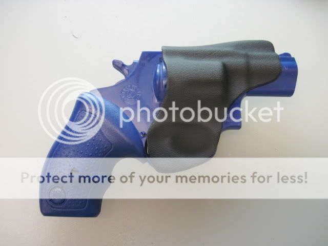

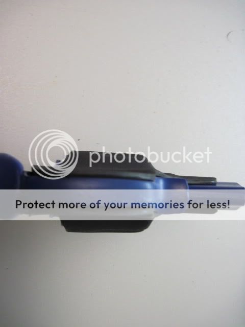

    Okay, this is the direction I would be exploring in if I were commissioned to build something along the lines of what you've described. I used a scrap piece of .080 Kydex.
    If I were doing it for real, I'd probably use two piece construction, rather than the fold over style. Either way, I'd use a large enough piece of kydex to make kind of a flange where the sloppy black 'paint' is in this photo. That's where I'd mount my belt attachment. To draw, you'd grip, and rotate the gun in the direction shown by the red arrow.
    Wow, that's at least two GREAT ideas that I didn't think of.
    Making it with two pieces, I could mount an adjustable screw above the gun, so I could adjust the tension until I got it just right. And I was thinking of making the "hole" on the other side of the gun, but now that I think about the draw, the way you have it makes much more sense. I am going to get a piece of kydex and try it out.
    I really appreciate the advice!
    BTW, does that blue gun break out of the kydex you made? or is it in there too tight?

    Quote Originally Posted by funklab View Post
    No problem. I enjoy experimenting with holster designs. It was fun.
    It does, but it's difficult. Not because it's too tight, though. I didn't put anything in that I can get a sufficient grip on. There's nothing for me to hold it by while drawing the gun. If I had made a flange at the top strap like I mentioned, I think the retention would be just about perfect.
    I wouldn't go any thicker than .080, if I were you. I could be wrong, but I really think that anything thicker will be too stiff.
    When you start working on your holster, if you find that it's too tight, there are ways to adjust that. Post pics as you build, please! I'd like to see how you make out.
