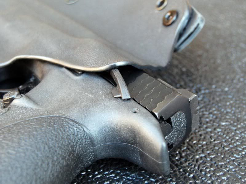

    Here's an M&P 9, with it's thumb safety about 1/3 of the way into the holster. By this point, the barrel and slide are well into the holster, so there's very little deviation possible for the thumb safety's straight-in entry to the holster. Nonetheless, there's plenty of room, at this point, above and below the thumb safety.
    Here, the thumb safety is about 2/3 of the way into the holster. At this point, the bottom of the thumb safety is in contact with Kydex, so that the thumb safety is fairly captured in the safe position. Note that there's still plenty of room above the thumb safety.
    With the pistol fully seated in the holster, the thumb safety is effectively captured in its molded pocket, so that it resists being accidentally swept off. If you look at these pics in reverse order, you can see that the holster can't push the safety off upon the draw. There is extra room in the track, so that holster doesn't contact the top side of the safety.
