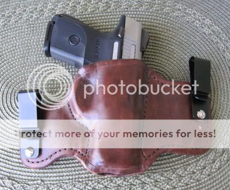

    I really like the way this holster turned out! It's very comfortable to wear all day long, and the gun disappears under an untucked shirt. The wide stance of the belt clips distributes the weight over a larger area so that the gun actually feels lighter, and makes on/off a breeze. It is height and cant adjustable also.
    Snugs up nice and tight against my body:

    Cool! Where did you buy the clips? I'd like to see a better pic of how they are attached please. :)
    Clips and all other materials were purchased from Tandy Leather. The clips are attached with what is called a "Chicago Screw" 1/2" in length. Here's a link to what they are: http://www.tandyleatherfactory.com/s.../1290-051.aspx
    I simply punch out a hole and slide the female part of the screw through it, attach the clips, and screw in the male portion of the Chicago screw. I make leather washers with a punch set also to place under the clip. You can use regular extended tooth lock washers to help stop clips from spinning. Hope that helps!
