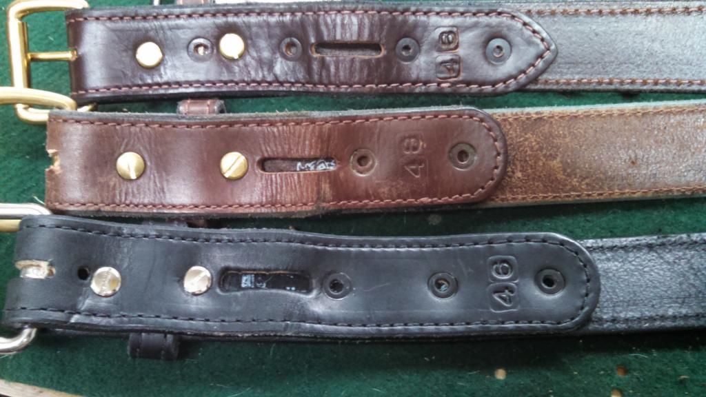

    I figured out how to shorten my gun belts without ruining the stitching at the tip. What you do is to take the buckle end and shorten it by cutting a new slot for the buckle hasp and then punching new holes for the retaining screws. Some of the older bullhide belts are "skivved" (thinned) at the buckle end, newer ones are not. You still have to cut the threads, but it is where you can't see it and by putting super glue in the thread holes in the final inch or so, the thread will not come unraveled.
    These belts were shortened 6 inches. As Bullhide belts run short by 2", they fit a 36" set of pants perfectly with the alignment coming to the middle hole with an IWB.

    That is how I have done my belts for years. Some had a sewn on buckle, but a Leather Punch (Pliers-type) has 5 hole size options and allowed me to replace buckles with 2 Chicago Screws (like pic above). Any holes needed for the buckle prong was easily made with the leather punch.
    I secured any loose threads with shoe "GOOP" (lasts forever). never really cared how many adjustment holes my belt had.
    Myself, I prefer the horse/bull hide belts without the stitching, when I can find them. I am the John Wayne type build, small butt & weight goes to belly... suspenders are a part of my carry life. 6'5" & 295 lbs, AFTER losing 40+ pounds... another 30lbs would be my ideal weight. Could happen.
