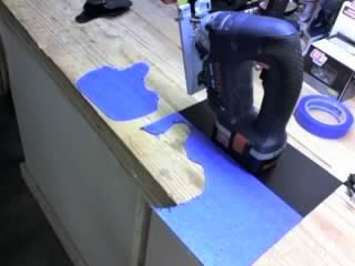

    The recent threads on appendix carry, which I prefer, have inspired me to make my own holster. I wanted an AIWB that had a body shield, straight drop, and sat as low as possible. I found a couple of makers that did that, however, the lead time was too much.....I want it now...So here is the rest of the story.
    I ordered three 12" x 12" sheets of kydex from knifekits.com

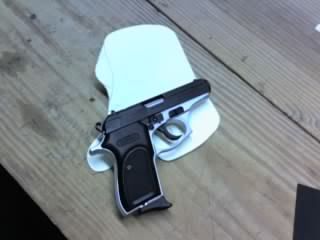

    I then made a template to my Bersa .380 using a manilla legal folder:
    Using painters tape to mark my lines I tranfered the template onto the kydex using my trusty bosch cordless jigsaw:

    After some hand sanding with various grits (60, 120, 400, 600) the edges were looking like a pro. I was now ready to apply some heat to bend the spine to match on both sides.
    Once you have the spine where you want it then insert your firearm into your favorite medium thick dress sock then apply some more heat and use your cheap clamp pad plywood press to mold the kydex to your firearm.
