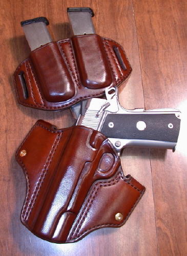

    I received my order today..
    I took some pic's and thought I would post some..
    I first had Dave refinish my belt. All the Kydex has been rough on it..
    The belt was rolled up and had stuck together when I unrolled it some of the dye came off..Over all it looks good..
    Here is the holster with loops..
    Saddle tan trimmed in black elephant..
    Again but with the Kydex clips that came with it..
    You can see where the black dye stuck to the holster when I removed the loops..
    Now with some Comp-Tac C-Clips
    He put some really soft amber colored suede on the back of the holster..
    Mag holder..
    Same saddle tan with elephant..
    The fit of the pistol is tight. It will break in nicely..
    The leather is super tough I think it will last a lifetime..
    Also the super soft amber colored suede is a nice touch.
    I can't get the elephant to look as nice in a photo as it does in real life..
    I really like the hand made look. It has a old timey feel to it that I like.
    The only problem is with the dye coming off or sticking to the holster. I myself would rather have a problem with the finish rather than how it was made...
    One last thing the suede is such a nice touch but I think it would work better if it covered the T-nuts ..Just something to try..
    Anyway thanks Dave and I hope you have a good vacation...
    I will update after I get to wear it awhile..

    I appologize for the dye transfer. I cannot explain it other than humidity. I did not attach them until shipping day; and I guess the same with the belt. Though I think it is more the "finish" than the actual dye.
    As far as the T nuts... i didn't want to cover them just incase they became stripped for some reason. I didn't want you to be stuck sending it back in for recover/replacement.
    I am glad you are over all happy with the holster, though I am not happy with the flaws. I am going to brainstorm and try and fix that for future rigs.
    I appreciate your candor and I hope you enjoy it.
    Take care and thanks again!

    I have a question for you, I have been looking at the photos a little closer and I am a bit worried about a few things. First the stitching on the mag carrier in the lower far right corner looks funny, I am not sure if this is where the stitching starts and ends, but it just doesn't look right to me. Also did you request the stitching to be raised like that? Most holster makers recess their stitching for obvious reasons, just wondering if this is something I need to mention to Dave or maybe you wanted it done this way. Also the loops on the mag carrier don't look very straight, not sure if it is the photo or what. I am glad you posted the photos as it gives me somethings to talk to dave about before sending money. Thanks for the info.

    Not wanting to be critical for it own sake, but the stitching looks amateurish, and the holster is not boned to the degree I am used to seeing in the holsters from the top makers.
    In addition, the loops on the mag carrier look pretty rough to me.
    Overall there is a lot of room for improvement.
    I never want to discourage a new holster maker, but I do not think it is doing him a favor to brag on work that is lacking.
    The important thing is that it satisfy the customer.
    Regards,
    Jerry

    What do you mean the "holster is not bonded to the degree I am use to seeing" I don't see that the photo shows a good shot of the edge of the holster. Since I was about to place an order with David I would appreciate your opinion.
    Let me say this that David is very honest that he is starting out in this business and has a lot to learn, he responds very quickly to emails and seems very friendly. I am all for supporting somebody who is still learning as long as it is a cosmetic issue and not affecting, or will affect the integrity of the holster later down the road. What has me most concerned is the stitching being non recessed in the leather.

    Yes, I have alot of room for improvement. I have been doing this, without any type of professional guidance, for only 2 plus years.
    My stitcher is a Tippmann Boss, which is a hand crank instead of electric. Yes, I agree my start/stop need work but this was the first holster with a suede back I have ever made. I also use 346 thick thread, which is basically saddle thread; so making it perfect, is taking a bit of time, like all things.
    As far as boning, I cut it as deep as I could and I don't like rubbing exotic skin to the point that it may damage the look or function.
    What makes it worse is lighting of the photo; when I spoke to Heith, he stated it needed the "bag trick" to break it in... I think that is a tight fit. The back is kinda "weak" because of the suede.
    I have been in contact with a "professional" maker who has given me pointers on what I should work on; I appreciate the fact he didn't tell me how so that I find the way that works for me.
    I can promise you, I try to make each holster as perfect as possible... Sometimes everything falls into play, sometimes it doesn't.
    I appreciate your comments and I hope to surprise you with improvement as each holster is made.

    I was speaking of boning the holster so that such things as the ejection port on a SA shows to some degree. Of course that can be overdone.
    Take a look here http://www.delfatti.com/photos/photos/206.jpg
    http://www.delfatti.com/New%20photo%...-HTL&DM-LP.JPG
    http://www.delfatti.com/photos/photos/216.jpg
    Del Fatti Leather - LP holsters
    Lightning Arms Sports
    Please understand that I am not suggesting that you not order from David. If it suits you I know that you are the customer.
    David has not made the number of holsters that the top guys like Del Fatti have, and few have reached his level of skill and design.
    All I had in mind was to give some constructive criticism in order to help him.
    I appreciate new makers, and we can use all we can get that have the skill to do first class work.
    I repeat that we do no favor to a new maker by praising his work without letting him know his shortcomings.
    I would like to see him become the next Lou Alessi.
    David, please take this the way it was meant and keep learning. No one reached the top without a lot of experience.

    [My only expectations is if one is going to critique, one should also offer a remedy (maybe I am still too much Army). I understand not everyone is a holster maker and just by looking at a holster, one cannot learn to build one by just that method.]
    Sorry, but I am not a holster maker, and cannot offer suggestions as to how to do it. I have posted photos that show quality holsters that meet or even exceed my standards to purchase. Sure you cannot learn by sitting and looking at photos, but you can compare your work with the best, and that should be a help.
    However, if you desire to sell many holsters you are going to have to compete with all other makers. Some are better than others, and no one would expect you to have the skill of Sparks for instance at this point in time.
    But if everyone brags on a holster that is not up to average standards of the craftsmen that frequent this forum the maker might think that he is competitive.
    That is the way I see it, and practice it. There is nothing personal about it, but I consider whether I would buy a holster that is posted. If I would not then I cannot in good conscience praise the holster. I could remain silent, but I fail to see how that is a help. I think that is one reason we frequent these type forum.
    There are newbies who buy holsters with which they will not long be satisfied. It is cheaper to buy top quality the first time. I have learned that by the "school of hard knocks" and three large drawers full of substandard holsters that I never use.
    Nothing personal, but when someone post photos I assume he believes it is a good one, and is likely to receive comments as to the perceived quality of the product..
    Don't be discouraged, and I hope not angered, by my comments. They are honest, and given with a desire to see you improve. Considering the back log of good makers, we can always use another skillful maker.

    I took some more pic's just now to try and show the boning..
    I used the flash this time instead of the sun and they look more like the actual color..
    The boning may not be as deep as some but the gun is snug in the holster.
    To the point of I used the old dress sock trick last night and now it draws perfectly!!
    Here is a shot of how it is molding it's self to me...
