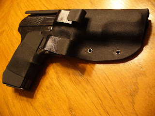

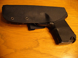

    Ok, I got around to putting together a carry holster for my Tok (Norinco 213). At first I flirted with a complicated IWB crossdraw design. It involved a trailing support arm that could have been made of either leather or kydex and would have to be angled just right to allow concealability, comfort & a good draw. It's an intriguing idea, but overly complicated and though I might mess with it in the future today I just wanted something easy that I knew could work. In the end, I decided on a very simple IWB scabbard design using a single piece of kydex. The dual J-hooks add a little bit of stability by being able to straddle a belt loop. I used the thinnest kydex I had (.63) to minimize any added width which as an added benefit gives the clips just a tad amount of flexibility so that they can be maneuvered onto the belt. It surprised me how light it ended up.
    The outside of the holster has the majority of the molding while the inside is fairly flat since that's the side that's against the body.
    I canted the holster a little rearward so that the barrel lays comfortably along the inside of my thigh when worn at the appendix position. It's still high enough to allow me to get a solid grip.
    It also works in other IWB positions, but I really like it at the appendix spot.
    I wore it this evening for a few hours at the mall and though I noticed it, it never hurt to wear. Now I have a way to carry my Tok concealed so I call this one a success.
