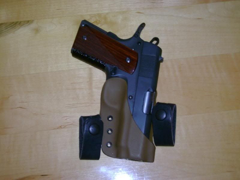

    southbound your holster looks great. how many holsters have you made?
    My first holster try is going to be a paddle for my Taurus judge.
    win
    tn
    252
    Quote Originally Posted by win View Post
    thanks guys
    lol I don't even know anymore
    I use to take pic's before I shipped them off just don't seem to have the time anymore...What I would like to know is how many C,J,and standard clips I have sold to folks...
    I have been messing around with paddles myself if you need any info feel free to pm me as well..
    I use .83 for the holster and .125 for the paddle...
