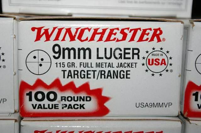

    The now famous Winchester 'White Box'...
    Winchester 'USA" [Actual brand name]
    9MM 115 grain FMJ
    http://www.winchester.com/products/h...s/default.aspx
    Back then immediately I noticed two things following the switch;
    1) My gun was much cleaner following a range session while running the WWB;
    2) My targets groupings were much cleaner following a range session running the WWb!
    I'd stopped buying Remington Yellow Box and stuck with WWB from that point on, except for minor exceptions when I'd either not be able to find WWB in stock OR if Dick's would have their buy one box of ammo get another half off sale.
